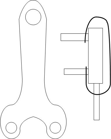

    There are plugs available which have a small handle on the back of them to facilitate easier removal when unplugging. I've also seen a wrap-around plastic thingy (can't really describe it better) which fits over the plug pins and forms a handle behind the plug. I think one of the charity organisations like the Lions was selling them. I'll hunt for more info.
      Can't find a picture but it kinda looks like this.
      Sorry if its not very clear, it's late and it's not easy to draw. On the left is the thingy flat as it arrives in the packet. On the right is how it wraps around a plug to form a handle. Maybe someone else can remember the name of it.

        Thanks for taking the time and trouble to respond, AndyD. I'm very impressed with your artwork
        However, this isn't really the answer I was looking for. These plug sockets really are excessively tight, so much so that there's a danger of pulling the sockets out of the wall when trying to remove a plug.
