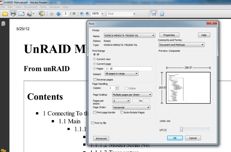

                    Martin
                    In Acrobat reader is autorotate ticked in the print dialogue?
Name:	reader print.jpg
                    The trick maybe is to leave the X by X boxes blank.
                    • Martinco
                      • Oct 2008
                      • 927
                      Thanks Ian ..........you are a star !
                      Yes, leave the boxes blank and choose only the "2" pages per sheet.
