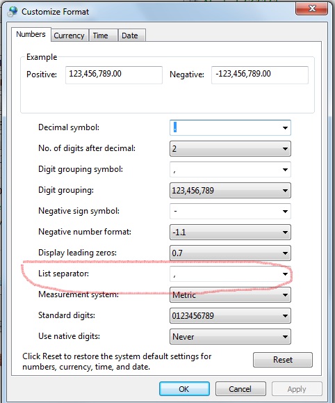

        Stevie, access the Windows 8 equivalent of control Panel, then Region and Language, then Additional Settings
        On the Numbers tab, change the List Seperator to a comma, the recreate that import file.

          Clive is correct - your CSV file format is incorrect. I have attached a sample one-line GL journal for you to look at. A tip: if you want to make sure that you use the correct format, manually create a single line entry in Pastel and then export the batch to a file, with CSV as the file extension. Also, don't include any double-quotation marks in your CSV file, i.e. "
          In Windows 8, over and above what Clive suggested, on the same Regional Settings screen, change the decimal symbol from a comma to a full stop and repeat the two edits in the Currency tab. Also make sure that your system is set to English South Africa.
