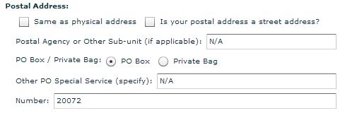

    Originally posted by JLC
    STATUS:
    Employer Postal Private Bag/PO Box/Other PO not supplied
    I hit this one with last year's interim submission.
    E@syfile has added some mandatory fields to the employer information area, and as usual we're supposed to be psychic.
    Worse still, some of the settings are a bit anal and unintuitive.
    Go to EMPLOYER ADMIN > View/Edit/Change
    Go to the Edit Employer section
    Go to Employer Address and Phone Information
    and complete / update any missing data.
    There will be missing data - just can't remember exactly what it was (I think it's the postal address data now that I think about it)
    What I do recall is the postal address section has a few curve balls, and I include a snapshot of the one section to demonstrate (in my instance) what you need in there for an ordinary post office box.
    If you leave those postal agency fields blank and don't have those N/A entries exactly like shown above, validation fails.
    UPDATE: With the E@syfile update for the period 201402, the postal agency fields need to be left blank if the postal address is a P.O. Box.
    All this is hidden in the latest manual on E@syfile, but of course for those of us who have been using it for a while... well, who among us struggling entrepreneurs always downloads the latest manual and peruses all the pages looking for changes from previous versions

      And you must click the little circle that indicates that it is a PO Box or a Private Bag.

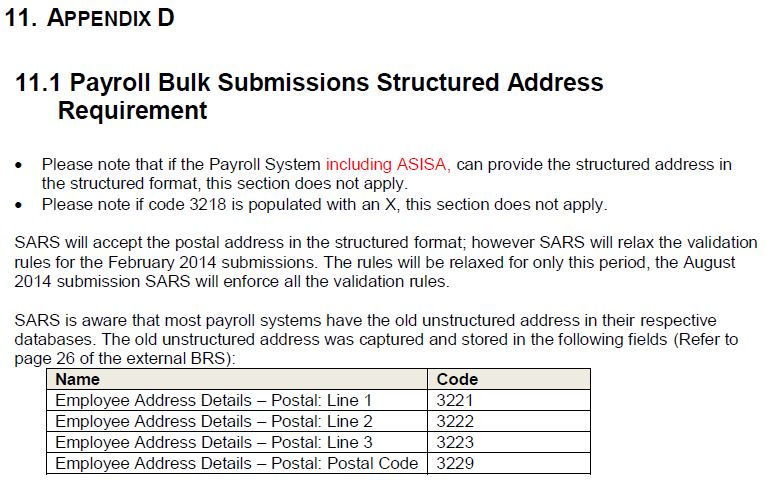

        and no code 3218 is used on the certificates.
        I've had a look at this issue and the code range relates to structured address data.
        Did you import data from a payroll package, perhaps?
