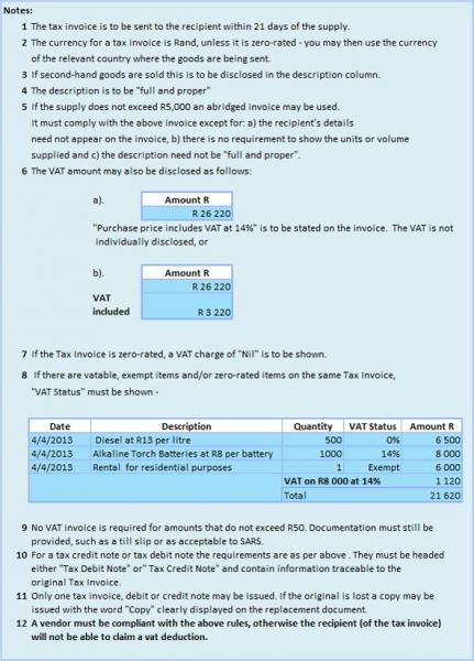

    If the item cost more that R5000.00 you need a full Tax Invoice with all the business details and VAT number on it.
Name:	TAX Invoice (notes).jpg
    Entering it as 01 in the cash book would then allocate the VAT automatically.
    Because it was bought on the boss's personal credit card, however, the VAT may not be claimed. If you have a review/audit and SARS request the documentation they would not allow it.
