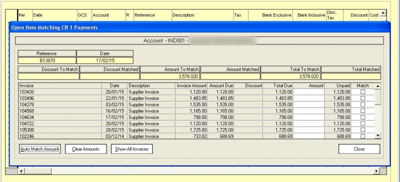

    Hi There,
    I'm currently working on Pastel Xpress 2009.
    When I do the cash book, Pastel has been set up to match the supplier payment to invoices. On the list it pops up on some of my suppliers there has been invoices that's been credited, but the credited invoice is still in that list to match. How do I remove those invoice as it becomes very difficult to know what to match and what not.
ID:	269361Click image for larger version

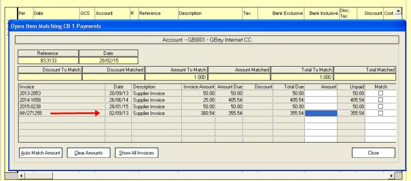

        Thanks guys for trying to help, but I feel I haven't explained the problem properly.
        I've got 2 suppliers, Gbay Internet and Gordon's Bay Security, and I have by accident entered a Gordon's Bay Security invoice under Gbay Internet. I have done a credit note for it as soon as I noticed it (I unfortunately have already batched by then) but even after the credit note, the invoice is still in the list to match to a payment.
        Is there a way to remove it from the list?
        • Neville Bailey
          • 2786
          In order to reverse a supplier invoice, you need to process a Return & Debit note, not a credit note - I presume that you did that, and that you matched the R&D note to the invoice?
          IronTree Online Solutions
          WALLACE WATTLES (1860-1911)
          • steffie250
            • Jan 2015
            • 5
            Hi Neville, yes I did do a Return and Debit, and have entered the invoice number in the "original invoice" block. Is there a different way of linking the 2 so that the invoice does not show up in open items on the cashbook?
            • steffie250
              • Jan 2015
              • 5
              I've just done a Return and Debit for a supplier again. Put the correct invoice number in the "original invoice" block, batched it and went and check, and the invoice is still available to match in the cash book. I need to know how to remove all these invoices that has been credited to not show as a matching item when doing the cashbook, pleassseee??
