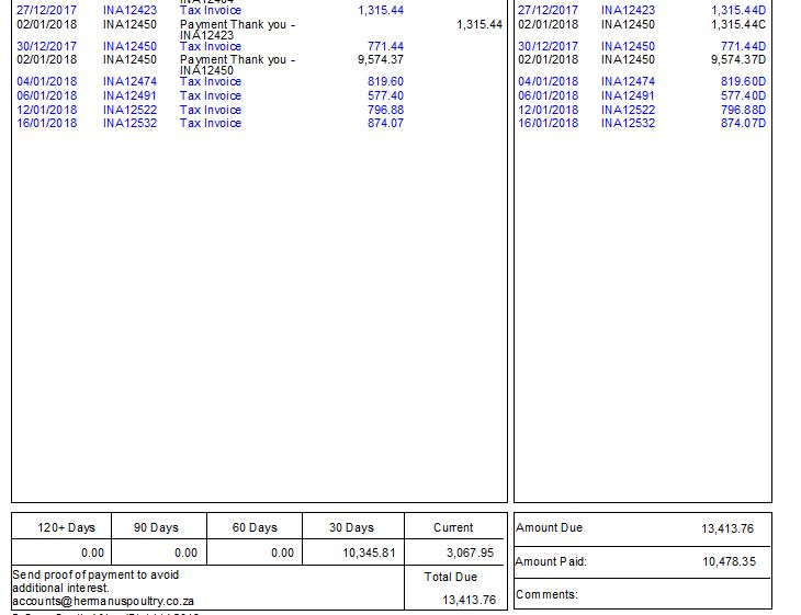

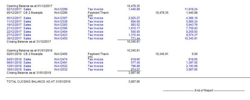

        Hi, Sorry to add to this thread after so many years. I have been searching if there is perhaps an answer to my problem.
        I have client's statements who are incorrect. Fortunately I remembered for a fact that a certain client paid their previous month's invoice, and could immediately pick it up.
        It reflects the client's payment on the debit side of the statement instead of the credit side, and thus doesn't deduct it. But if I look on the customer detailed ledger, the correct outstanding balance reflects.
        Please see pics...

        • Neville Bailey
          • 2786
          That is an indication of Open Item data corruption.
          I can fix that for you via TeamViewer, using my datafix software.
          Please send me an email or PM if you would like to arrange a remote consultation.
