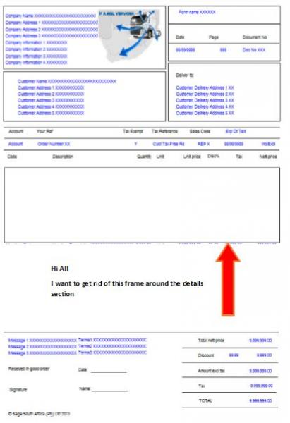

    Hi all
    I just need to remove the box printing around the Detail section in my invoices, and two days later still can't get it right. It's probably something quick and easy so if anyone could please help I would really appreciate it?

      Post snapsot of what you want please.
        Hi
        I have uploaded the .jpg file. I hope this works

          Hi cindyreuben.
          Just point at the edge of the box and click. You will see that it has been selected by little blue boxes (called handles) appear on the corners of the box. Press the delete key on your keyboard ... and it should disappear. Save changes.

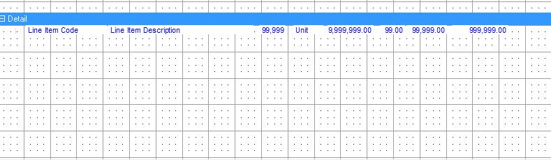

            Hi Mike
            The problem is that in forms designer the box isn't showing. I have snipped it for you.

              Hi Mike
              I fixed it. I had to change the paper size in my printer as the problem was actually hiding in the heading section. Then it was visible in forms designer after I dragged the heading to make it bigger. I could then delete it. I wouldn't have guessed it without your help so thanks.
              Cindy
