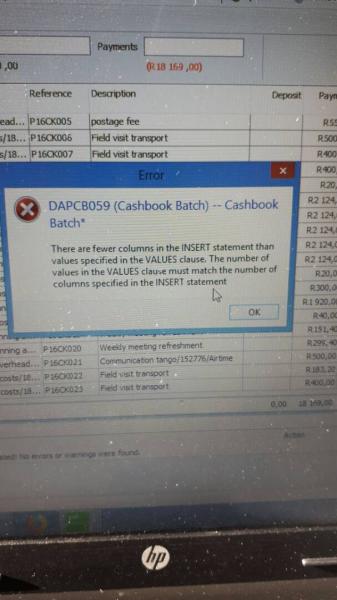

    Good Evening All,
    Can someone please help interpret the error message I am receiving in Sage Evolution. I am processing transactions in the cashbook but receiving the attached error message. I have validated the batch and no errors found. However, when I save of try to post/update the batch I get that error message.
    Any layman's solution?
    Thanking you in advance!

    Hi Nakwila, you can try this ...
    On the Pastel company, go to Setup | Company Parameters| Formats tab, ensure the 1000 Separator value is set to a comma (,)
    Do the same on the "Multi-Currency" tab

      Hallo Mike, thank you very very much! It worked just as advised, this issue had my grey hair growing...Again thank you.
