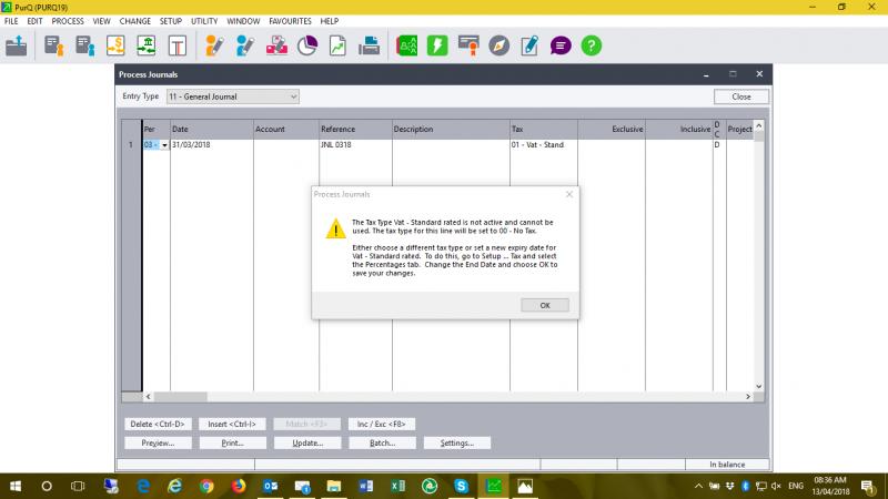

    Hi
    I've installed the update on my Version 18 Pastel Xpress, got the message about the new VAT codes and even got the message where it asks you if you want the VAT defaults to be changed.
    But now I want to capture a March 2018 bank statement and I get the following message: The Tax Type VAT Standard rated is not active and cannot be used. The Tax Type will be set to 00 No Tax. Either choose a different tax type or set a new expiry date for VAT Standard Rate. To do this go to Setup... Tax and select the percentages tab. Change the end date and choose OK to save your settings.
    What is the most effective way of getting rid of this message while I'm still capturing March 2018 information? What will happen when I start capturing information for April 2018? Will there be more changes I will have to make manually?

      In the cashbook journal, open the Settings button and check if the default tax type has been changed to 15.
      If it has, change it back to 01 until you finish March.
      It might also be using the new default tax types for inventory or for your supplier accounts.

        You can use the Temporary Vat Rate @ 14% to capture the Bank statement, your March invoices / process credit notes etc for March.
        The 01 tax type that used to be the standard rate 14% wont work as the expiry date was set to the end of March 2018, therefore you are receiving that error.
        If you need further clarification feel free to email me, balan.sharlene@gmail.com. Hope the info helps

          This is not quite correct - the expiry date works on the date of the transaction, not on the computer date, or today's date.
          So, if she processes a transaction dated March 2018 today, and the defaults have been set to 01, the system will allow it. I have just tested it.

            I tried reinstalling the patch to see if it doesn't improve my situation. Because my Pastel does not allow the 01 if I post something in March.
            I tried capturing a journal now in March 2018. My Default Tax type is 01. So technically I should be still allowed to capture, as 01 was still open up to 31 March 2018.
            But I get the same message. See the attached file.
            I'm sure I'm not the only one who has this. Posts date 1 April work fine. Just anything before 1 April that's problematic. I'll just change the date in the Tax settings for the 01 to 1 April until I'm done with my March processing. I found that to be the fastest fix.
            Thanks for the help.

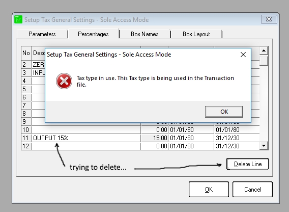

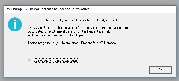

              I followed your tutorial for manually changing/creating 15% VAT tax types before I knew about the patch to v14.2.2. Thereafter, I followed the link to patch. I am now confronted with the screen "Pastel has detected that you have 15% tax types already created..."
Name:	Pastel Tax Change.jpg
              I have followed their instruction to manually remove the tax types in order to have Pastel setup the defaults, however I get the error message "tax type in use. This tax type is being used in the Transaction file." when trying to manually delete tax type previously created.
Name:	tax type in use.jpg
              I don't know how to proceed from here, if you have advice?
