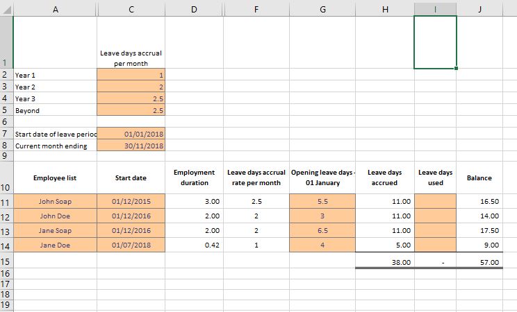

    Good day everybody,
    I need a formula on how to calculate leave days due in Excel.
    In the first year of service the employee gets 1 day per month, in the second year of service he gets 2 days per month, and in the third year of service he gets 2.5 days per month.
    Please can somebody assist me with this?
    Kind regards and thank you in advance!
  • JKS
    • Jun 2011
    • 13
    Hi
    link to file: https://we.tl/t-QOz4Pmq37F

      Thank you so much!!!!!! It is perfect!!!

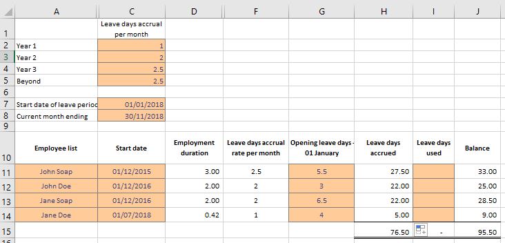

        Made a small change to one of the functions. please download again.

          Hi Everybody!
          We are nearly there. I am still struggling with this formula.
          For some of the employees it is giving them one day extra?
          Please, is there anybody that can assist with this?

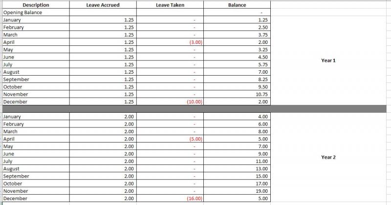

                    BCEA gives a minimum of 15 days per annum leave. It can be increased but never decreased.
                    No specific formula - 1.25 x 12 = 15 days per annum.
                    Normally I create columns as follows:
                    Column A = Description - i.e. January Leave Accrual, February Leave Accrual etc
                    Column B = Accrued - 1.25 (copy this write down)
                    Column C = Taken -
                    Column D = Balance
                    So it would look like this:
                    The formula in Cell D3: =D2+B3+C3
                    Copy this down for the first year in the balance column
                    Year 2 D16 = =D14+B16+C16

                      @Pocohantas In a small organisation, I would create a worksheet per employee as indicated in my post above. With the first work sheet being a summary as the per original worksheet indicated above. This enable you to look at an individual leave or you can look at the entire company.
                      If you are a bigger organisation, buy a software solution.

                        Thank you! Is the leave per month for year 2 2days per month?
                        • rh1
                          • Dec 2017
                          • 16
                          Yes. The original poster stated 1 day and then 2 day in the next year. But if it remains the same, just make it 1.25
