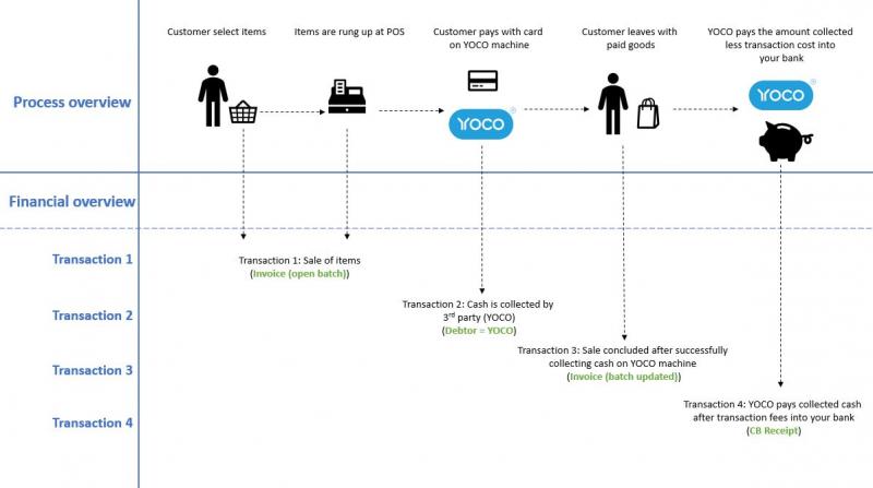

                Hi Ola
                What a fantastic question. I have been mulling over this transaction, what data flows and how to account for it the entire evening.
                In my view your debtor is YOCO. They collect cash from your cash customer at the point of sale. So when cash is received from YOCO through your cash book receipts it should be allocated to YOCO, not the cash customer he/she already paid and for that reason is not a debtor to start with. I have made an illustration below to show how there are 4 transactions in my view.
Name:	Capturing YOCO transactions on Pastel.jpg
                I am currently thinking how I can illustrate to you how to capture the transaction quickly in Pastel. I am almost there and will share it asap.
                I do think it is very important to see the transactions as they really happen, because this will help sort out your receipting process.
                I hope this has assisted. I will post soon post how to use Pastel to quickly post this.

                  Hi Alec
                  I have been checking with some clients and some treat this in a very strange way.
                  The correct treatment (in my opinion anyway), although I don't know how you would do it in Pastel, is that the original sale is the equivalent of a cash sale, because you have no further claim against the original customer.
                  The "cash on hand" account .... I can't really decide if it is a cash equivalent or a debtor but I lean towards cash equivalent. That account credits the linked account the next day, less a fee. Personally I treat the fee as a bank charge. Perhaps it is a commission?
                  It is not a quantum leap from the old credit card clearing mechanisms, just faster and mostly cheaper.

                      Thanks Andromeda
                      You are so right, it is not a quantum leap forward. For me it is important to see the entire transaction and to then setup your structure and Pastel in such a way that it reflects it.
                      I have gone further and also made the following illustration of the transaction as it happens.
                      I really appreciate us all having this conversation as I do believe YOCO is a fast and inexpensive solution for SME's. But the standard Pastel processing method is not fast and cost efficient, so we need to see how we can set processes in place to make it quick to capture in Pastel.
