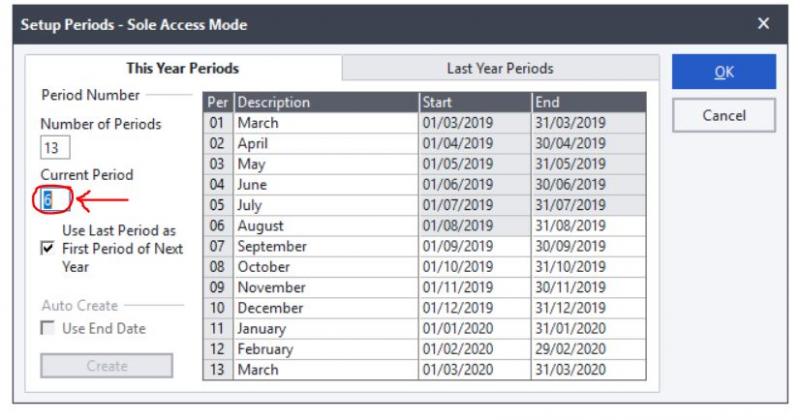

      In fact, there is an option in Pastel Xpress and Pastel Partner to restrict certain or all users (other than Supervisor users) to process in a particular period only.
      To activate this control, edit each user's processing options (under Setup...Users/Passwords...Users) and deselect Multi Period Processing under the General Ledger section.
      Then, as the Supervisor, go to Setup...Periods and define the current processing period number in the Current Period field.

          The user is restricted to processing in the period number field in the Setup...Periods screen, on the left side.

              Hi Neville, we have created a demo Pastel company for testing and customer training. I just tried out the restriction of Multi-Period processing and it works so well. Thank you Neville. This is really a great additional control to put in place to ensure that capturing is done in the same period and is done on time.
              Attached is the period screen where you set which period is open for processing as Neville indicated. It took me some time to find (my eye just kept scanned right past it).
