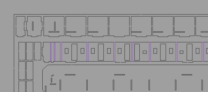

                Using a laser is rewarding but frustrating, we have learnt not to cut architect students models as the air assist blows all the small pieces inot a black hole.
                  I do a lot of work for those students. A trick that I use is to put tags on the parts. All you do is to break the lines here and there and remove a 0.5mm section. The little tag keep the parts tied to the main sheet of material. Better still - tell the students that they have to add the tags otherwise you won't cut the job.
