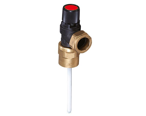

    Or there's a problem with hot water constantly flowing either through a tap, pipe leak or a TP valve leak. The TP valve leak is a good one because it usually flows through a pipe into a gutter where nobody can see it.
    TP valve; Click image for larger version
