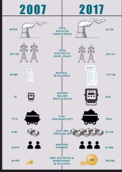

          Came across this pic this morning - Figures paint an interesting story - "Connect the dots "
