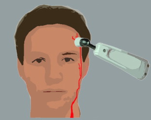

      One of the tricks when using these "forehead ir thermometers" is to make sure you are measuring over the temporal artery rather than in the centre of the forehead.
Name:	temporal artery temperature measurement.jpg
      Even with the fairly cheap and simple one I have managed to lay my hands on, there is a setting that sets the device was designed for (body temperature measurement over the temporal artery), and one for measuring objects. According to the paperwork, what this does is adjust the emissivity setting - 0.97 for the human forehead and 0.95 otherwise.
      When it comes to compensating for ambient temperature, apparently the fancier forehead thermometers measure the ambient temperature at the same time they're taking the ir reading and adjust the result accordingly for greater accuracy. The other factor that can throw an accurate reading off is very recent physical exertion.
      I liked the advice in the paperwork - the most reliable results are obtained when the individual has been at rest in a room at a reasonable ambient temperature for 30 minutes. The paperwork also claims an accuracy of +/- 0.3 degrees C, which I find pretty impressive for the money.
      I gently suggest if you are getting a wild reading, either under or over - have the person quietly seated in a room for 10 minutes or so and check again.
