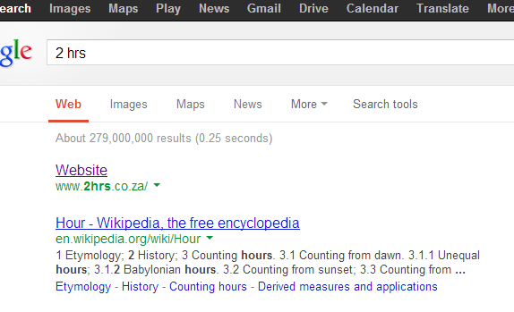

    Can someone please help me with a Word press site. We have just had a site done by a guy on wordpress. Apart from a few problems we are having, one of the problems I have is if you type our name or telephone number under a google search, it cannot find our wordpress site ? The second problem I am having is if you type our website www.2hrs.co.za in a facebook posting (where you normally post) it comes up "Under Construction" . Does anyone know what the problem is please ?

    Google search works here.
    Try a different browser.
      @ ian - Ok I see that but if you click on it it comes up as : http://2hrs.co.za/ not www.2hrs.co.za. why is this and is it a problem ?
      And as I said if you type in the actual company name HR Solutions it does not come up in google !
      Does this perhaps have something to do with the different URL's above - Is it not something on Wordpress that the guy has loaded something wrong ?

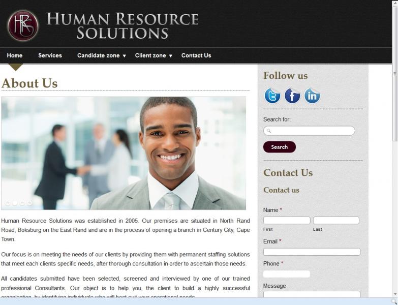

Name:	bla bla bla .jpg
                      Vision of company:
                      To deliver quality service through efficient & professional recruitment, thereby assisting our clients in the growth of their businesses. Our immediate vision for the company is ensuring our Cape Town branch is up and running supplying candidates to our valued Cape Town clients.
                      Source
                      mmm
                      seems to work just fine...
