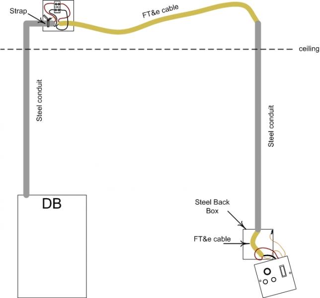

        Which parts of the socket circuit are the original 2-wires in steel conduit and which parts are PVC conduit with housewire or FT&E?
        Am I along the right lines with this setup?

            I didn't take a stab at this cause I didn't understand the question fully.
            [ATTACH=CONFIG]2680[/ATTACH]
            Almost. there are no cables involved. This is an old installation. The original socket circuit was wired as such: two pvc wires, red and black, exiting the Db board conjute metal piping, mounted upon cleats and running through the roof. Every so often there is a joint, with another 2 wires, and those 2 wires run away from the cleated wires and into a metal conjute down to a plug. The lighting circuit is similar. All the metal conjute pipes are bonded at the exposed part in the roof, to a earth wire and then usually to the water pipes. The earth wire does not travel down the pipe with the red and black wire.
            The question is, when the socket outlet is replaced, does there have to be an earth wire delivered down the conjute pipe to the new socket outlet (i support this theory) or are you allowed to drill a screw into the metal box and attach a wire from the plug socket to the screw. (I do not support this theory)
            Disregard the extensions for now that was actually for another question

                    Depends if you're using the actual wireway as the earth or you're just earth bonding the wireway as an extraneous item. In my sketch above the backbox and steel conduit in the wall are bonded, they're not used to actually carry the earth.
                        the older installations used the piping and metal boxes as the earth...there were only 2 wires in the electrical installation...red and black...no earth...the piping above the db would be bonded with a bonding strap and water pipes etc...including the electrical piping and earth wire from the overhead supply cable...all connected to one point...the problem however...over the years the pipes in coastal areas have rusted creating a higher resistance...deeming the earthing inadequate...so back to connecting an earth wire from the plastic socket or even replacing the metal one with another metal one...personally i would run a new earth wire back to a point were i can connect in to the incoming earth wire...be it an overhead line wher ethe earth wire would be running across the roof sapce or to the DB in the case of an underground armoured cable treminated at the DB
