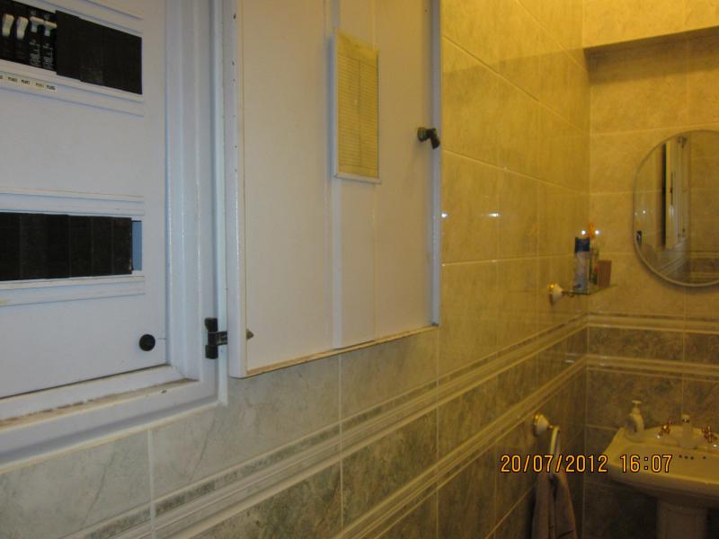

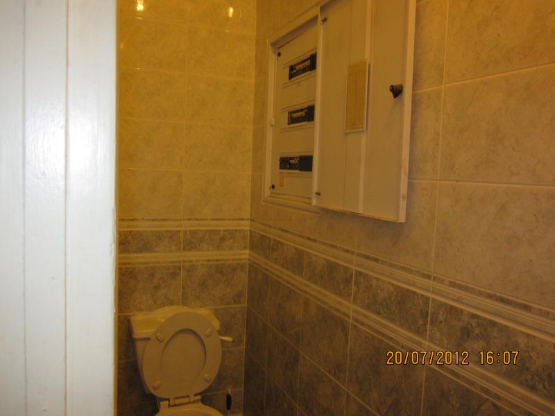

    No bath and no shower, but can you have the distribution board over the toilet?
Name:	ielect pics 066.jpg
    The db is also about 2.2m away from the hand basin.

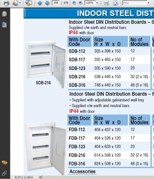

            Hmm, I thought the sink was 2 meters away so you must be referring to the toilet flush...which is plastic. To be honest I suspect the enclosure might be IP 44 as it stands even without a rubber door gasket. All the panels with door gaskets that I have in my stock are IP55 or better, I just checked. From what I can see in the photos I would just take a laissez faire stance on this one and give it the benefit of the doubt.

              Yep - it's the toilet cistern refill valve I'm concerned about. And I believe requiring IP44 is fair enough to cover water flying around if something went faulty there.

                You're welcome Dave. Did the setup in the photos pass muster 'as is' or is it still a contentious issue?
                  • 22820
                  Nope, the photos did the trick as is and I managed to join the dots.
                  For IP44 the circuit breakers must be covered, not open - but the cover doesn't have to be tightly sealed at the joint to the db (which would make it IP55)
