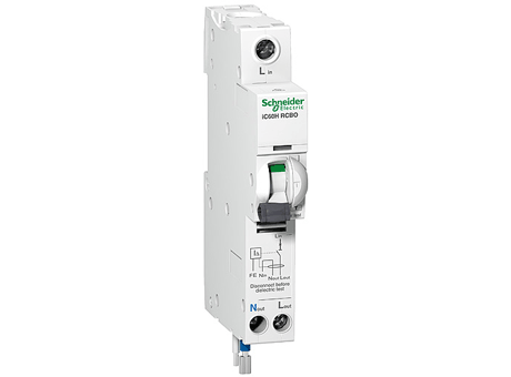

          An RCBO is similar to a normal circuit breaker but it also provides 30mA earth leakage protection as well as the standard overload protection on a circuit by circuit basis.
          The average domestic installation has a single earth leakage breaker that protects the entire installation which introduces a few problems. For example a single earth leakage fault on only one of the circuits causes the entire installation to trip in most cases which certainly isn't ideal. Also many electronic appliances have an acceptable amount of background earth leakage during their normal operation. This background leakage can accumulate to a substantial amount if there's several PC's, TV's and fluorescent lights or LED drivers being supplied and it can cause annoyance tripping of the earth leakage breaker even though there's not actually a fault present.
          Using RCBO's means that every individual circuit has it's own 30mA earth leakage protection so if there's an earth leakage fault on any one circuit, only that circuit trips.
          This is a single pole RCBO, it only interrupts the live of the circuit, the neutral connection you can see is just for reference.

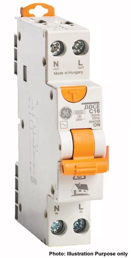

          The problem with just interrupting the neutral with an earth leakage fault is that whilst the circuit will become dead the fault won't actually be cleared if it's N-E leakage. That's why it's better to use the type below which is 2-pole, it disconnects the live and the neutral together if there's a fault. (It's actually an SP+N type circuit breaker because it only provides overload protection monitoring on the live wire, not the neutral.)
