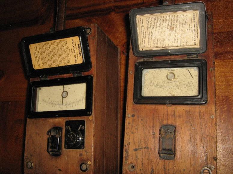

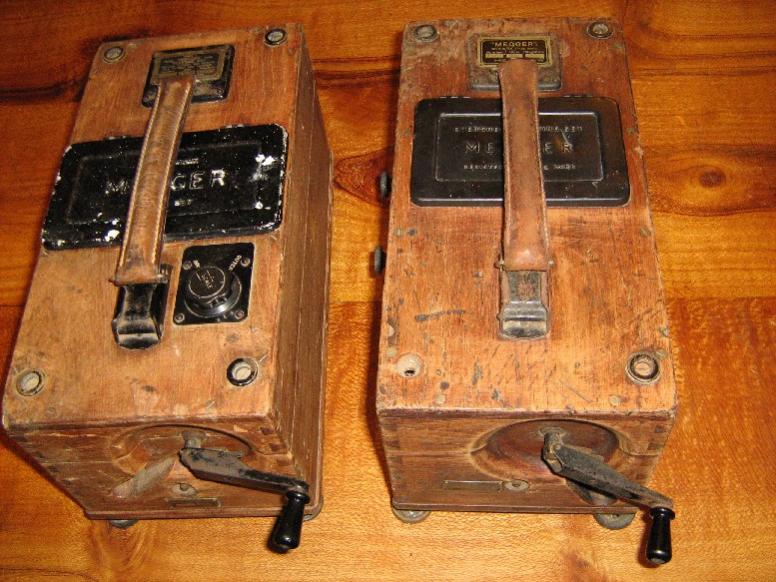

    I picked up these two beauties for a steal of a price a few months ago
