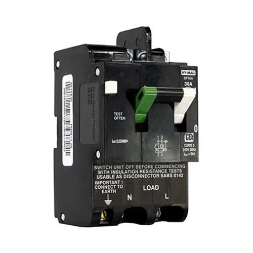

                When would a fault before, (upstream) of the E/L device cause the E/L to trip? Meaning there is no fault under the E/L (L & N disconnected at E/L terminals load side). Ramp test clear on E/L 27Ma @40Ms. TN-C-S supply.
                  #38
                  I see you treated yourself to a ramp tester, I'm jealous, I haven't bought any new testers for several months now .
                  How often is it tripping? Is it regular as clockwork or is it random?
                  It's not one of the old types of RCD as per pic below that has an earth reference wire on it by any chance? If it is there could be a slim chance that an earthing fault on the supply side could present parallel paths that could cause a fault in a neighboring property to cause the RCD to trip.
                  I've only ever once experienced an external problem causing RCD nuisance tripping and it was an RCD that tripped almost every evening when the streetlight outside the house switched on. I can't for the life of me remember what make it was but I replaced the RCD with an identical new one and it also did the same. After another replacement of a different make it stopped happening. I did some power quality monitoring at the supply and couldn't see any evidence of transients that would point to arcing when the streetlight switched on so eventually decided it was a harmonics issue with that particular brand of RCD but I could never prove it.
                  I've heard hearsay of poor connections/arcing on the council supply side causing RCD's to trip as well so maybe check the Ze and the neutral-earth voltage of the supply.

                    Thanks Andy. New SABS approved Schenker SP E/L with L N only no earth. (tried 2 new ones). Total random intermittent tripping. Ze (external impedance all ok when tested (0.17Ω).
                    You were spot on. Poor connection & arcing N/E on council supply in street feeding to house. Municipality came out open their street box and the N/E was arcing, burning, loose connection, hanging on a thread. Fixed it, all OK, 8 hrs no tripping.
                    But why? i don't understand why a fault before the E/L would cause it to trip.

                      TBH I'm not sure why it would cause an RCD to trip, there's no current imbalance on the load side which is the criteria for tripping. I'd guess it's an anomaly with the internal electronics maybe.
                      How's the tripping fault, is it still holding?
                        #41
                        I think it has to do with reflected current flows in the E/N wires. All circuits connected to the council point on the E/N circuits are connected in parallel to all the different loads, however when there is a break on the council side supply line, as is the case described by ACEsterhuizen, and because of high current flows and inductance in these circuits, a pulse is injected into the neutral line towards the load side. THE RCD , by nature of its design, is to trip when there is an imbalance in the currents in the L and N circuits. When this pulse comes down the line, there is a mismatch between the L and N, and the RCD can not differentiate where the imbalance is coming from, source or load, and the mechanism then trips.
