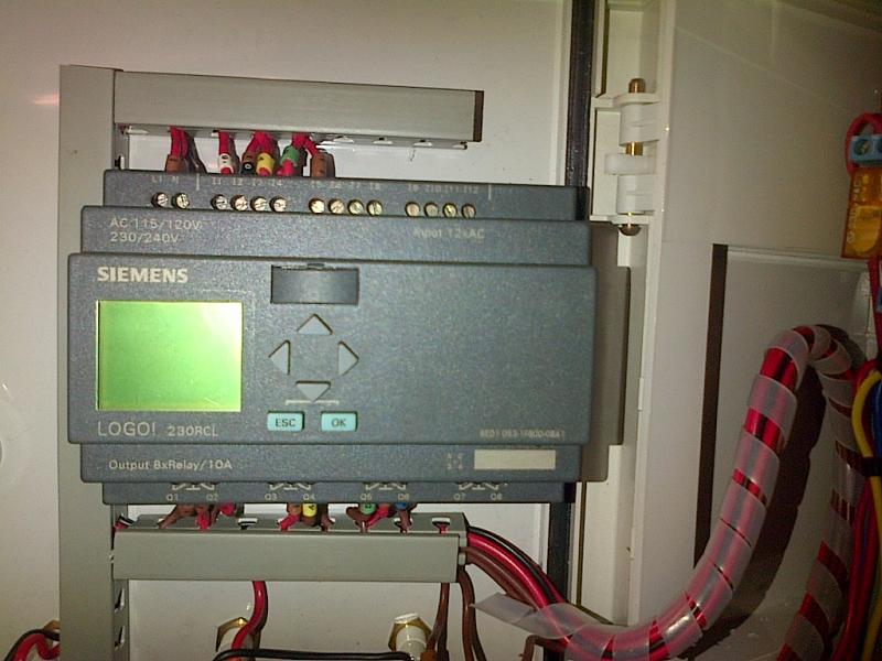

    P.L.C. Software
    Hi are there any P.L.C. boffins out there I have 3 machines that I must get Going trouble is the control system is via a Siemens LOGO 230RCL they are approx 10 yrs old and I know that contacting Siemens would be futile as they will only want to sell me a new system what I need is the software ( program) and the dongle to connect the unit up to my computer so that I can read the program to see what the heck is going on as there are timers switching solenoids and a pump, fans and lights.I have tried to download the software from the net but Siemens obviously dont allow it I can only get an explaination on the operation of the unit,also the programming is in list or statement wich I am not familier with I have done some programming but in ladder. I will attach a picture of the plc it has 12 IPs and 8 OPshttp://www.theforumsa.co.za/forums/attachment.php?attachmentid=5117&d=1418756670&thum b=1&stc=1Click image for larger version

    hi mikilianis i have a cable and a cd you can borrow. its also the logo 230 ,but 4 inputs and outputs i think. the cd is dated 2005 and should cover your one.
    and i 'm in cape town
      Are you sure you need the program disk? You can scroll through the program using the built-in keys and display and you can change the timings etc.
      What problem do you think the controller has?

        Thanks Bergie I am in Wynberg Cape Town And would be very grateful if I could borrow the cd and cable, can we arrange for me to collect it from you tomorrow the18th or is that inconvenient for you my contact number is 0845879276

          Thanks AndyD I would like to see the whole program and not just sections as it will be a learning curve for me as I have mentioned I have only used ladder logic to program plc's at present I do not know exactly what the functions are there are various cycles that the machine must go through
