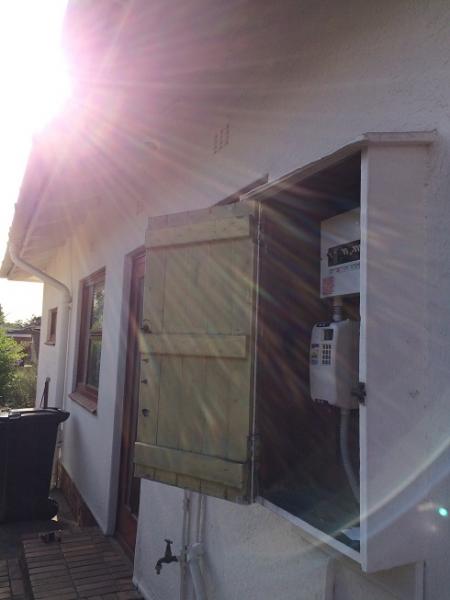

              Hi Guys, thanks for all the posts, this is what I was referring to
              • Sparks
                • Dec 2009
                • 909
                Not acceptable. That is an "interior" surface board. It my not be used outside. The wooden box is an attempt to protect it but it does not meet the water/dust protection requirements for an "exterior" board.
