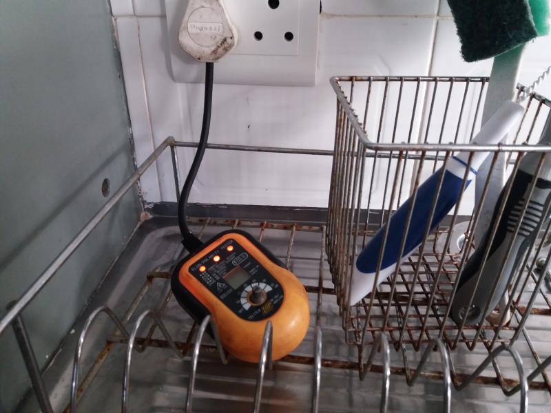

                Floating earth

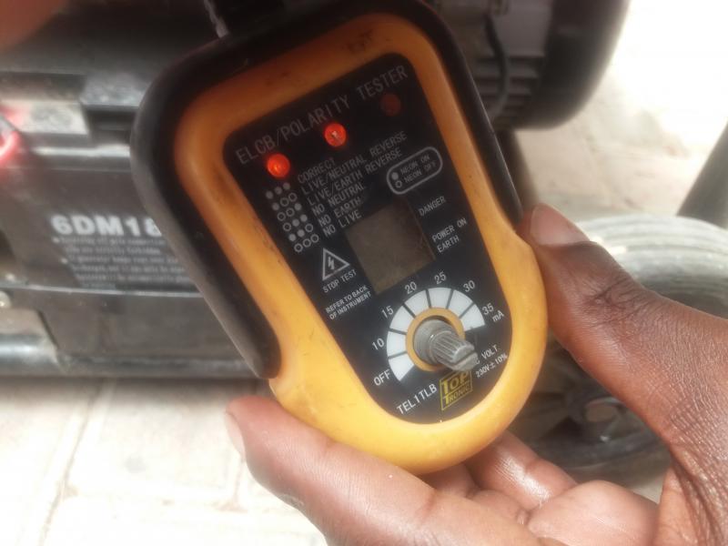

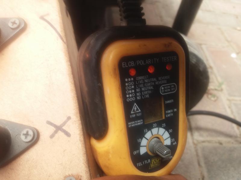

                With earthspike. 3 lights.

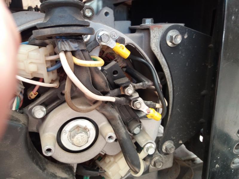

                My earth/neutral bridge ( yellow lugs )
                Testing in kitchen with genny.
                We modified 2 genny's today. The one was the Ryobi 6900 and the other was a Fragram 5 GFD-3 5kva.
                Tips. The wiring coming from the stator are not wired the same in these 2 models, so you need to make sure which one is being used for the neutral by removing the control panel in front.
                I will carry on checking different gennys, but it seems to me that anything 5kva or bigger is not vov, but one still needs to confirm.
                Peace out .. Derek
