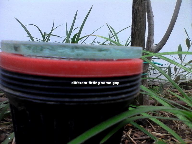

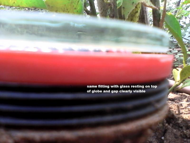

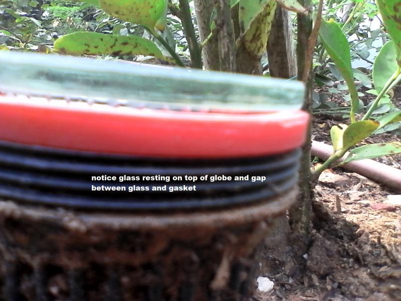

    Hi all
    I would like opinions/comments from electrical colleagues in respect to the following problem I have with garden spike lights which I installed for a landscape architect and having serious issues with them regarding the leaking of water into these fittings due to the incorrect size globe. This is my opinion about and I have also had reports from 2 independent lighting specialists confirming my opinion. Would appreciate your thoughts and comments.

    those are the plastic spike lights? nice that they dont rust but the max is a 35 watt halogen lamp as it cant handle the heat. if you use a 50 watt they tend to melt. if you are using led maybe they are a bit high for the fitting. but no doubt its the height causing the leak.
      • 4927
      Looking at the sticker in the last photo it specifies the lamp type and maximum wattage but doesn't give a max lamp length so I suppose the customer might have the expectation that any GU10 lamp that's 35w would be suitable.

        Had exactly the same thing this week. Those are the radiant spike lights. I quoted on the fitting and particular brand of LED which turned out to be just a tiny bit to long. There are few brands of LED which are the same size as a normal GU10 Halogen. Osram are short enough to fit (check though as there are obviously all different wattage of Osrams, think it was 5 watt that fitted). The Ellis, the ones builders warehouse, fitted fine as well but all the local builders here seems to have stopped stocking them. I'm just going to have to pay more than what I quoted for an LED that fits so I can keep the customer happy. Win some, lose some.
        Just got to get the lighst completely dried out and check before I try and reinstall....

              These globes and fittings were supplied to us through a landscape architect who were supplied by some or other lighting supplier for us to install. The standard height of a GU10 globe is 58mm and these specific globes supplied to us are 65mm high(too high)(bright star)
              see photos. So my point is that the original supplier supplied the wrong height globes thus causing the lights not too seal properly and now I am in a major battle with the maintenance manager all the way up too the client/principal agent about the lights leaking water and tripping the circuits. This has been going on now for over 2 months now and is absolutely frustrating as every second week I have to repair this fault at my cost which is clearly a supplier issue but they are adamant this is an installation flaw. Why we were not just given the specs and told to supply and install is beyond me. Hope this clarifies
