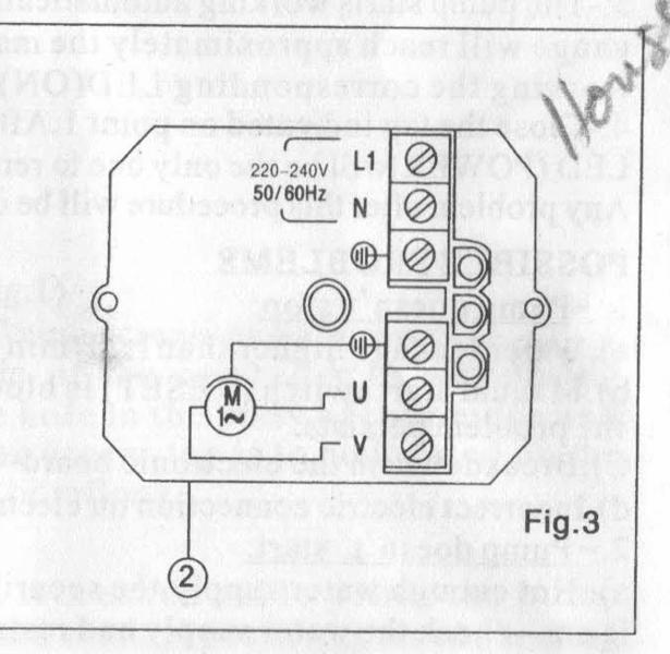

    Hi guys, my first post although I have browsed your great forum many times.
    I need to wire a new pump controller (switching pump on and off depending on the pressure)
    The connections on the controller is as follows:
    E
    L
    N
    and
    E
    U
    V
    Obviously the mains go to E (earth), L (Live) & N (Neutral) and E, U and V goes to the pump
    Could you please advise how to connect the pump (U & V) Single phase having the L, N and E

    It seems that the controller assumes you have a capacitor start and run motor with a built in mechanism to take care of the start capacitor, which you generally will not find with a submersible pump.
    The U and V connections from the controller would simply go to the 2 wires of your motor supply cable.

      It should not matter which way around the L & N of your pump wires goes since it is AC.
      Maybe to be safe confirm which connection is L by having the controller switch on an see between U and Earth and the V and Earth which one gives you 220v also just for interest sake check continuity between Earth in & Earth out so make sure it is internally bridge or if you should put a bridge in yourself.

        Hi, thank you very much. I have tried all options and the fault light on the controller stays on and the controller does not work. I have discarded this new automatic controller type system and went back to the old fashion pump with tank and pressure switch.

            The diagram shown is just a 2-pole switch, it's switching the live and the neutral of the pump supply as it's shown. It should be compatible with any single phase pump which has a running current equal or less that the AC3 rating of the switch contacts.

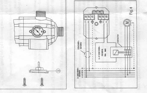

                According to the specifications, this controller can be used on any pump as long as the pressure does not go beyond 10 bar. It can even be used on a three phase pump in which case the wiring is as per the following diagram. Thanks for all inputs. Click image for larger version

                    Well with this diagram it makes perfect sense...
                    The controler feeds the contactor's coil and the contactor feeds the motor.
                    As long as your contactor has a 220v coil the controler can switch the contactor. As for the motor depending on the supply circuit it can be anyone of the 2.

                        Just to clarify, currently I have the water pump, and it connects directly to the mains through a fused 3-pin 13 amp plug. Now I need to connect the water pump through the automatic pump controller which I have just acquired.
                        So should I remove the 13 amp plug, then I connect the wires from the water pump (L, N and E) to the U, V and E on the pump controller directly?

                          In that case the answer is - Yes. But ensure that the switch contacts are rated for your motor current.

                            Hi, which of the 2 ( U &V) is live or neutral?
                              • 1495
                              On a single phase motor rated at 220v it would be immaterial and make no difference
                              Generally U would be live
