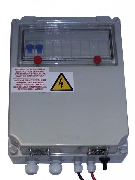

    Hi Ians,
    I have this already.
    Picture here - 500W Inverter
Name:	DB Picture.jpg
    Brochure on the unit
