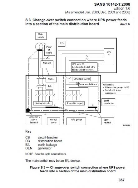

        In addition to the above it could also be an unbalanced neutral, which means that one or more plug neutrals (the ones that trips when load is connected) is not connected (Both Live and Neutral) through the Earth Leakage. Time to wire that Inverter and db box correctly :-)

          Yup, definitely an unbalanced neutral on some of those sockets.
