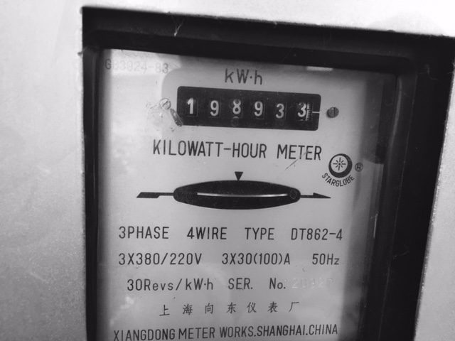

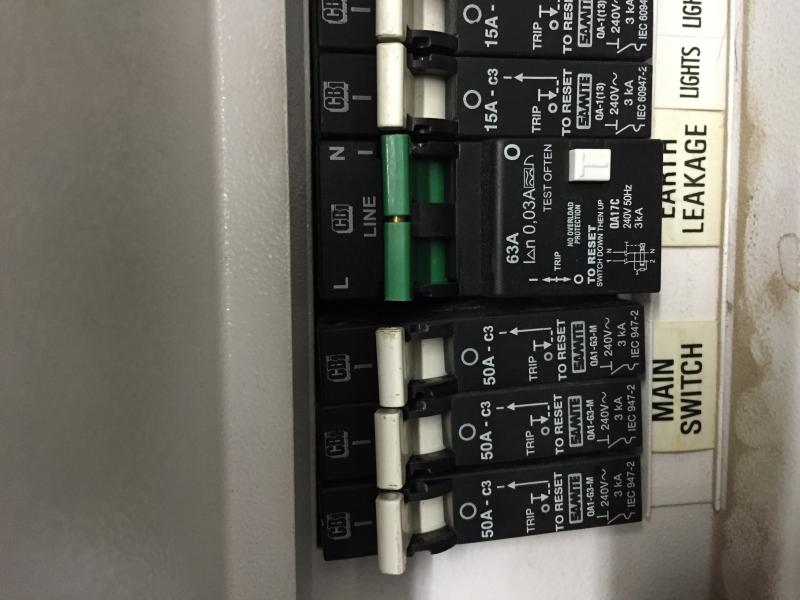

            I attach pics of the meter (residential estate so not a council meter) and the main switches and trip switch on my DB board.Click image for larger version
Name:	DB board - main and trip switch.jpg
ID:	264628Click image for larger version
Name:	Electricity meter.jpg

              hi solarfan . your main switch is 50 amps 3 phase. (3 x single pole breakers are used which is not compliant).if you can run your household on 50 amps single phase then you could rewire the db to have everything on 1 phase and not use the other 2. eskom want all the phases to be balanced ,but i wouldnt worry about that. your availability fee every month might be more for 3 phase than single phase.
              • Seanmt
                • Jun 2015
                • 4
                If you discard 2 of the phases you will only have 50 amps available. this may or may not be enough for your house if you have everything on at the same time. you will need to get an Electrician to determine this.
