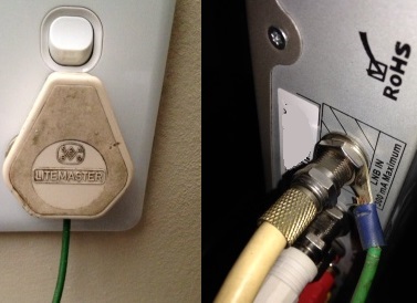

                  Well this is how earthing is done, as you can see the block on my very very very old decoder is clearly marked. My inverter runs with a modified sine wave out put is 230V at 50Hz i have no problem at all with my DSTV
                    [ATTACH=CONFIG]5782[/ATTACH]
                    Morning Tec0,
                    This is exactly how i earthed the PVR 2P with still no luck at all on inverter.
                    The old decoder in their Xtra view setup, is exactly the same as yours in the picture...it has no earth connected to it and still runs perfectly in inverter mode.
                    Hence my thoughts towards the PVR being the problem in this equation...
