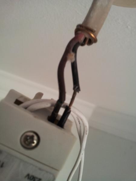

      Nice picture, I assume that you do realise that the use of "twist ties" is also illegal.
      Sometimes a picture says so much -
        Care to elaborate on that? I am just asking because when i got the contractor in to replace all the lights in my home, "twist ties" was the norm" They are all gone now but somehow the guy that did the first COC didn't mention it and he cost me a lot of money to date and I would love to know more because this will be yet another thing he overlooked.
        My home is up to code now but it cost me a small fortune....

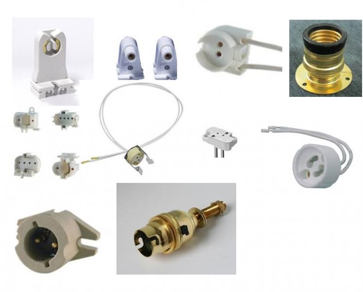

                My understanding is that generally a 'lamp holder' is not a 'luminaire', it's a part of the luminaire that the lamp actually inserts into. These are lamp holders;Click image for larger version
                The only time a lamp holder on its own would qualify as a luminaire would be if it would fall under the note in the luminaire definition in 3.48.
                NOTE A batten lamp holder or a lamp holder suspended by a flexible cord is a
                luminaire.
                I don't see that reg 6.14.4.1 would extend to the entire 'luminaire' or 'light fitting' unless it was a batten lamp holder suspended by flex. Therefore there's no way a luminaire or light fitting would be exempt from earthing.

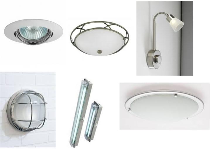

                A luminaire or light fitting is the complete lighting assembly including the lampholder inside obviously. Luminaires;
                According to the regs the definition is;
                3.48 luminaire
                appliance that distributes, filters or transforms the light transmitted from
                one or more lamps and that includes all the parts necessary
                supporting, fixing and protecting the lamps but not the lamps themselves,
                and, when necessary, circuit auxiliaries together with the means for
                connecting them to the supply.

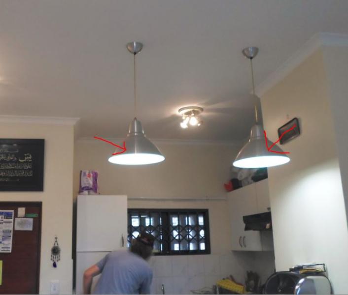

                    Here's one I got presented with this morning.
                    It is a low hanging Radiant light fitting with metal ceiling cup and reflector/shade over a kitchen counter top -
                    The bottom of the metal reflector is 1.8m above floor level. It's a 220v luminaire. Our test for earth on the metal reflector revealed no continuity back to the main earth point of the installation. Closer examination reveals there is an installation earth conductor available at the point of consumption, but no earth connection point provided to connect to within the luminaire, and the cable between the two metal parts is twin flex with no earth conductor.
                    Ultimately the luminaire seems to be installed and connected as designed...
                    Thoughts, anyone?
                          [ATTACH=CONFIG]5888[/ATTACH]
                          Thoughts, anyone?
                          So it shouldn't be earthed?

                            I struggle to understand why any light fitting out of arms reach should not be earthed. If someone is on eg. a metal ladder and gets a shock while changing a bulb or doing a repair then that person could fall from a height as a result, making it more dangerous than something that is at arms reach.
                            It's not like it's a big deal to connect an earth wire...
