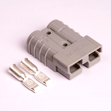

      I use a Anderson Battery connector as a means to disconnect the battery in circuit.
