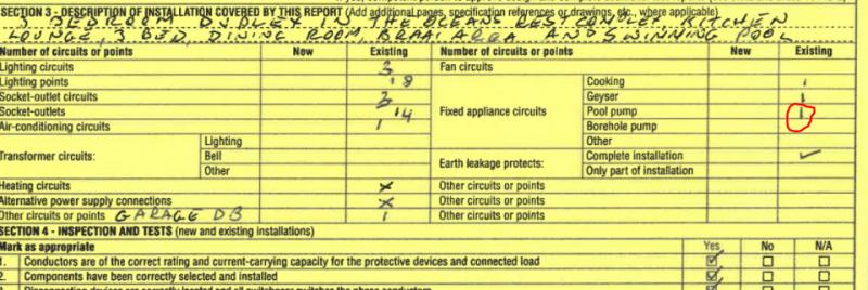

                            Good day, I am currently in the process of buying a property.
                            The COC was done and certified as correct.
                            However, im of the understanding that a pool circuitry is supposed to be independent. The current connect is the pool circuitry is mixed with indoor plug points. Is this correct? the pool breaker is a 30A break with cabling of 1.5mm2 and 2.5mm2, is this correct?
                            the current COC states that the pool circuitry is independent but clearly is not when i drop the breaker.
                            Please kindly advise.
                            Thank you in advance.
                              • 1495
                              #44
                              Hi
                              When you talk of dropping the breaker - Is it the Earth Leakage unit ? This will drop numerous circuits
                              The 30 Amp feeding 2,5sqmm does not sound correct , but it will depend if it is an isolator or there is a smaller CB protecting the " breaker " upstream.
                              A bit difficult to comment fully based purely on the COC attached
                              Maybe a couple of photos will provide clarity
                              • tharissamanikum
                                • Oct 2021
                                #45
                                No, I meant when I drop the circuit breaker labelled pool on the DB box, the pool circuit is isolated as well as plug points in the house. This clearly indicates that the pool circuit comprises of plug points in the house. Is this in accordance to SANS regulations? What pictures would you require?
