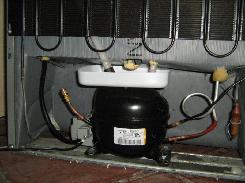

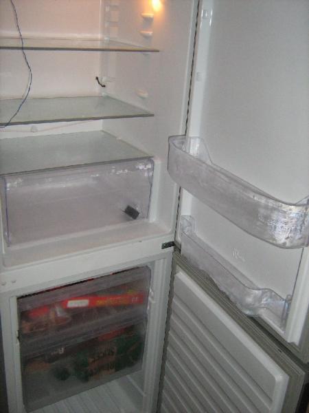

    I recently got around to repairing a domestic fridge that’s been kicking around in my workshop for probably 2 years now. It belonged to a neighbour that didn’t want to fork out the amount for a new control board and new compressor and dumped it with me. It was originally an R600 (isobutane) unit and I’m not keen to work with highly flammable/explosive refrigerants but eventually I came across a suitably sized, second hand, 134A compressor and found myself with some playtime the other day so I flushed it, vacuumed it and converted it.

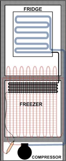

    It's a pretty standard almost-frost-free type of fridge, it has an finned, static evaporator coil inside the freezer cabinet and a standard evaporator plate in the back wall of the fridge compartment. Both evaporators are in series with the freezer fed first by capillary and the chiller/fridge getting fed second from the freezer left-overs as it were. The condenser is the standard black steel convection type that stands proud at the back.

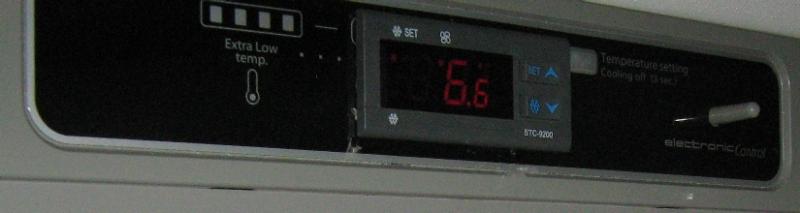

    Instead of installing an extortionately priced new manufacturers control board that did almost nothing other than temp control by 4 x presets and would take 3 weeks to arrive I installed a generic 2-probe refrigeration controller which gave me the advantage of being very accurate temperature control, being able to more tightly control the defrost cycle, a temperature display accurate to 0.1 degrees and alarm facility if the fridge ever stops working and my food starts defrosting.

    I ran the fridge and it turned out the 134A compressor was fractionally oversize by what’s known in professional engineering circles as a ‘ball hair’. After I got it down to normal operating temp and balanced the refrigerant charge it was very very close to being in a vacuum on the suction side. With a substantially oversize compressor it can result in condensing noise and under condensing/running hot but none of these symptoms were present and it ran well.
    It was early evening in my workshop when I tested the fridge, it was empty and it took about 1 hour to get from 30 degrees to 2 degrees internal cabinet temperature at which point the controller shut off the compressor. Not wanting to hang around any longer I threw a power monitor on the fridge power supply to record the on and off times throughout the night so I could see in the morning if there were any problems.
    Next day I checked the power log and everything was as expected. I could see the running periods and the off periods once the set temperature was reached and I could also see the defrost period that happened for 15 minutes in the early morning. From the regular pattern of the power log the fridge was running for around 10-12 minutes and then remained off for approx 35 minutes. Great I thought...success, a nice cheap fridge I can use at home for the bulk monthly shopping stuff so I promptly located it in my laundry room next to the small chest freezer.

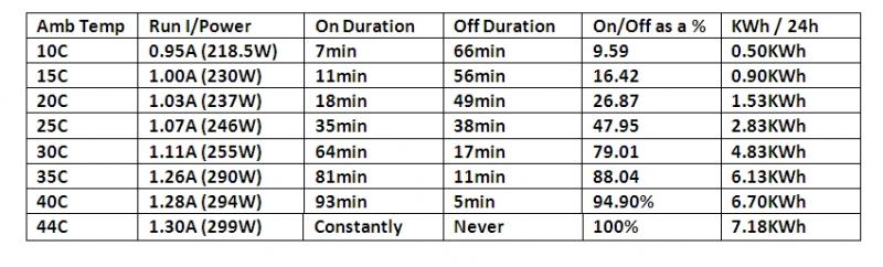

      As standard, with no extra insulation, here’s the run currents and on/off times for a range of ambient temperatures;

      I was astounded by the results, so much so I redid some of the tests to check their accuracy. Of the repeat tests, none of the results were more than 10% different and all but one were within 5%. What they show is that a normal, recent generation, double door domestic fridge can consume anything between 0.5 units per day and 7.2 units per day depending solely on how hot the room is that it’s sitting in.
      I realise my tests aren’t exactly scientific or under tight laboratory conditions and there could be some errors creeping in but they were repeatable with similar results.
      With this particular fridge it costs about 14 times more in electricity when the room is 44 degrees C than when it’s 10 degrees C. Yes, these are extreme room temperatures but it costs over 3 times more in power when the room is 30 degrees C than when it’s 20 degrees C and this kind of temperature swing can be expected in any normal house on any normal day.
      The problem is twofold and you get whacked from both sides as the room temperature increases. Firstly at hotter room temperatures the compressor run current is higher and the efficiency of the refrigeration system is lower so more energy is consumed to do the same refrigeration work load (see the run currents in the table above). Secondly the insulation losses through the cabinet escalate rapidly as the difference between the internal fridge temperature and the outside room temperature gets higher, the on/off times as a ratio or percentage testify to this.
      I’ll leave you with this as food for thought for now and I’ll add to this thread later. Experiments and testing are still ongoing as we speak.

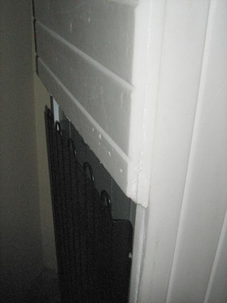

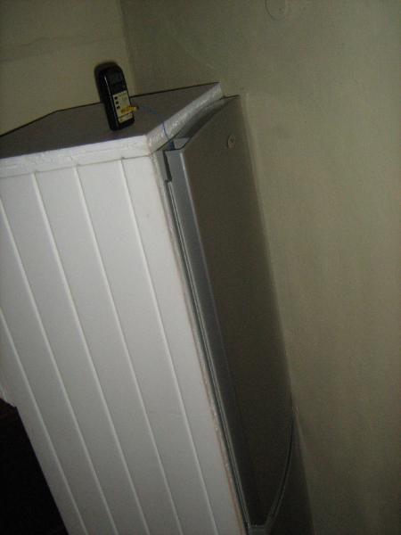

              After the astonishing results of the first round of tests I added some 40mm high impact polystyrene insulation to the top of the fridge and to the full length of the sides and also to the top half of the back of the fridge. By most standards it might not have been the prettiest of cladding jobs but it was effective from an insulation perspective.
              The areas without extra insulation now are the bottom part of the back of the fridge which includes the compressor area and behind the condenser grille and underneath the fridge on what is effectively the floor of the freezer. The logistics of installing extra insulation in those areas would involve relocating the compressor, relocating the condenser grille and installing it under the fridge would block the gap that allows air circulation from in front of the fridge, underneath it and up the back of it which is part of the airflow that cools the condenser and therefore would negatively impact the efficiency of the refrigeration system. At this stage I don't want to butcher the fridge beyond the point of no return, it's already being used to store food and I'd like to keep it as a usable unit.
              Here's the insulation;

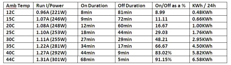

                Approx 60% of the cabinet area has extra insulation, 40% is as standard. I repeated the tests exactly as above with the exception of the 10 degree C ambient test because the lowest temperature I could achieve last night was 12C.
                I think at this point I'm going to draw a line under testing of this particular fridge and start again from scratch with a brand new one that's unaltered from its original design. I'm going to see if I can find something on a special offer tomorrow, if so I'll be back in business testing again by tomorrow afternoon.
