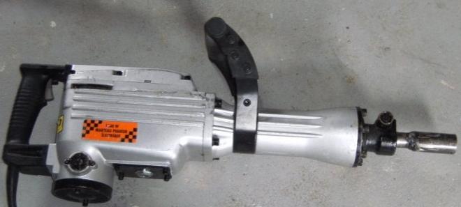

          I like that, 6 spikes deep is good. I also usually go 6-8x2.3m spikes deep if it's a sandy area and depending on the supply size would try for a sub1ohm impedance. Good depth usually gets a good Ra reading especially if you can get below the water table. Did you knock them in the old fashioned way with a sledge hammer or did you use a jack-hammer with an SDSMax rod driving attachment? Last time I used a sledge hammer was a couple of years ago on a remote site with no power, I thought I was having a heart attack after the first 3 rods and ended up getting a generator.

            I didn't know you can use a SDS hammer drill for this! Wow! Next time I will look into this attachment, as I already have the drill!

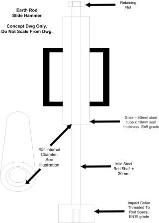

              I also have a slide hammer I made specially for earth rods, It's still manual obviously but it's a lot easier than a sledge hammer and it works really well

              Getting below the water table is always good and rust on earth rods has very little, if any, negative effect on their Ra impedance reading from experience. Also over time the ground settles and compacts against the rod, if you go back and test a rod a year or two after you installed it I guarantee the readings will be far better than when it was newly installed.
