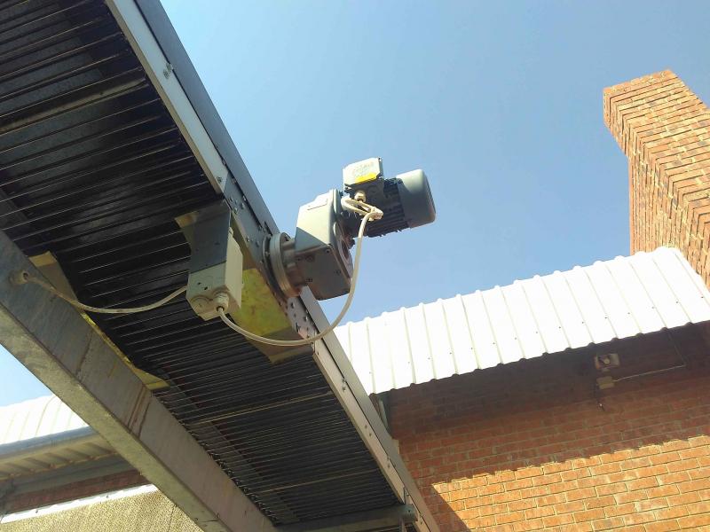

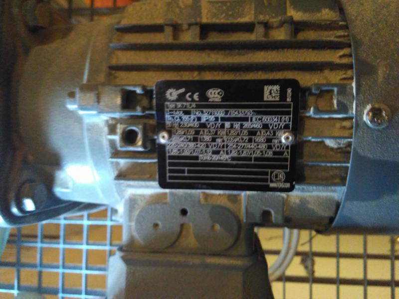

    I have 5 of these small .37kw 3 ph ac motors driving one continues metal grid conveyer via a gearbox, installed at various places along the conveyer each feeding from their own contactor, also installed at different locations.
    These little motors all work in tandem to drive the belt.
    I need to control these 5 motor's speed very accurately and from one location (at the end of the conveyor). The speeds of the motors must be exactly the same or it will damage either the conveyor or the motor or the gears. Can it be done and how. Any help or advice would be appreciated. Thanks.

    You can use a single VFD in V/f control mode and with a pre-selected curve to run all 3 motors, there's also the option of using an encoder if very accurate speed is required. If you need to limit torque to prevent conveyer damage in the event of overload then vector control would be the best option.
    It's highly application critical and there's several ways to skin the cat so without getting too deep into it I'd suggest you speak with the technical department at one of the bigger drive companies local to you. They should be easily able to assist you with the design and a final spec.

      Thanks Andy I have contacted various VFD suppliers including Mitsubishi. Your suggestion of one VFD seem to be the simplest and most cost effective one, but would distances be a problem? Some motors more than 100m away from the controller?
        Yeah, 100 meters may be an issue, how old are the motors and what insulation class are they? Again I'd consult with the drive suppliers or agents.
        I remember in the early days of VFD's even 20 meters used to be an issue but nowadays the cable lengths can be much longer although I've never seen 100m. The problem comes with the IGBT rise times which are very fast and tend to set up a standing wave with long cabling, this tends to cause premature motor winding failure effectively due to simple overvoltage. I usually draw the line at 20 meters for a standard VFD but I know there are units designed with different PWM switching transistors and they also play around with the carrier frequencies as well to allow for longer transmission distances. There are also impedance reactors you can fit which lengthen the rise time and prevent motor damage. Running shielded and fine stranded cabling can also help sometimes.
