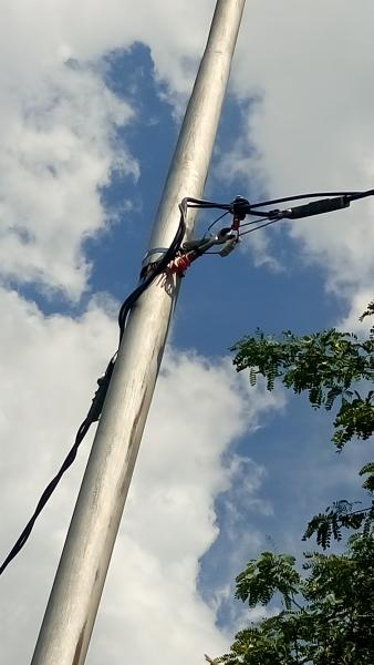

    Can anyone throw more light on how Jhb City Power selects and manages their contractors? It seems they have farmed out all the work to contractors, who, according to my experience, are not suitably qualified or experienced, or properly managed. I've seen this over the years from the guys then send out to attend to the never-ending mains supply problems I have. Solutions tend to be quick fix and level of workmanship is generally shocking.

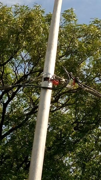

    In particular, their solution to getting street lights working again (after not being able to come up with secure circuit breaker covers on the poles) is to now string up ABC cables between the lights at the top of the posts, on the bends. A hole is cut with an angle grinder to access the cable. This could impair the structural integrity of the pole but that is not the issue I want to write about here: they are wiring the normal circuit breakers to the cable in the open air without any protection from water / moisture / dust ingress, which besides failing a common sense test, is contravention of the SANS 10142. This is not in isolation, I've seen it all over the place where they are doing this

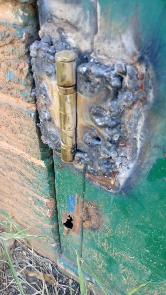

    Also a pik of some choice welding of sub station doors by said contractors, or perhaps even by City Power themselves.

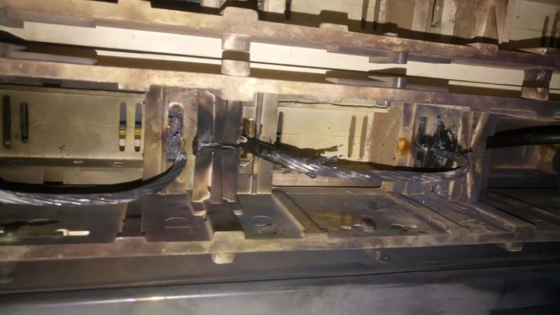

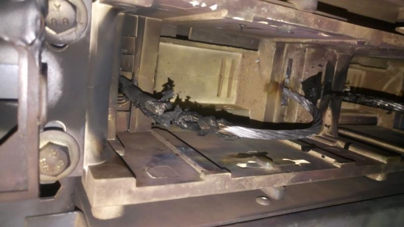

Name:	2018-08-02 10.17.59 (Small).jpg

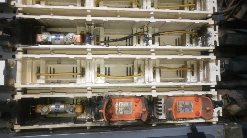

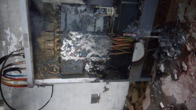

        GP Wire used as fuse
Name:	2018-08-06 11.42.51 (Small).jpg
        GP wire used on top of blown fuse
Name:	2018-08-01 14.55.43 (Small).jpg
        Fuse board with some original fuses
Name:	2018-07-24 11.00.05 (Small).jpg

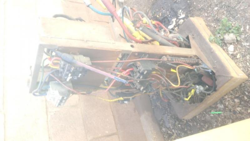

        The local street db, cover is loose
Name:	2018-07-18 09.34.35 (Small).jpg

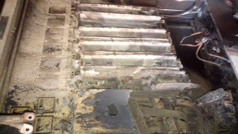

        Fuse board that burnt down because of GP wire used as fuses by CP personnel in flashy new truck

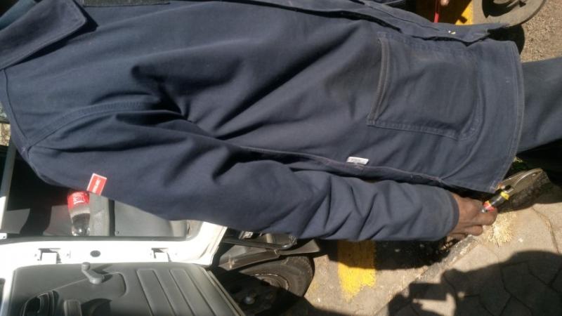

Name:	2018-07-17 10.45.05 (Small).jpg
            CP staffer stripping GP wire for fuses

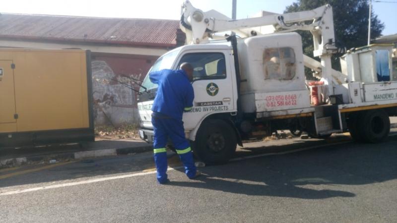

Name:	2018-07-17 10.44.47 (Small) (Small).jpg

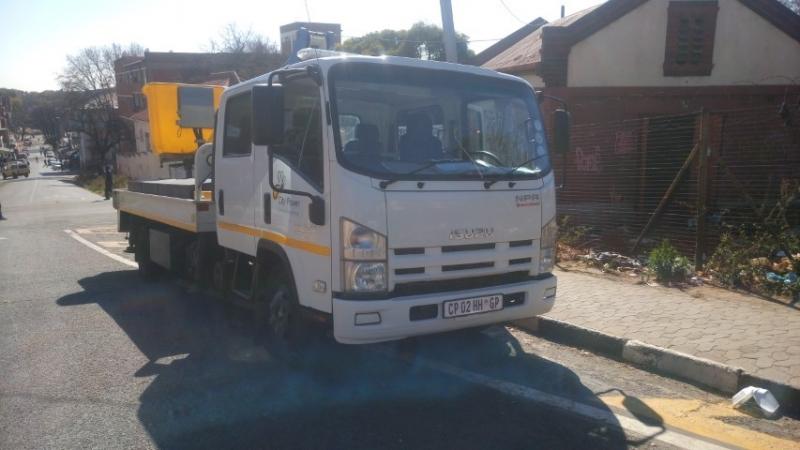

            Flashy new CP truck in front of neglected sub station

              Today a man & his assistants in a decrepit bakkie comes to my house around 11h00 after tending to my call logged at 05h00 CPWEB2327615 due to power out during the night. Firstly his bakkie stinks of dagga smoke (not the first time I have experienced this with CP Contractor). Asking him what he has done, he said he replaced the Red Phase fuse. I ask him what rating, he says 300A. I ask him about checking / tracing the overloading circuits he says its another job that CP must give him.
              Power blows out again just as he drives away. I check the substation (doors are open) and all he did was wire the fuse (2nd pic above). I try call the Area Manager, he refers me to the supervisor as always. No one can find the supervisor, after holding for 30 mins I give up for then.

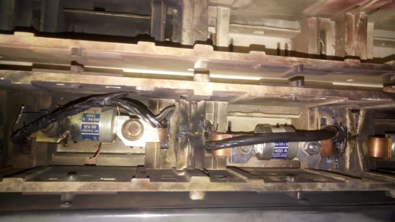

                      And it gets better!
                      Fuse that was 'hardwired' by contractor on Monday burnt the fuse board down on Monday night.
Name:	2018-08-07 09.38.12 (Small).jpg
                      The hard wired fuse that cause the burn was the middle on the LHS
Name:	2018-08-07 09.37.01 (Small).jpg
Name:	2018-08-07 09.36.15 (Small).jpg
                      Contractor was dispatched with large generator yesterday. Power was restored but I am still getting relatively low voltage, meaning overloading of conductors still exists (?)
                      I'll refrain from rants of diabolical dysfunctionality and gross incompentence for now.
