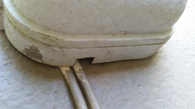

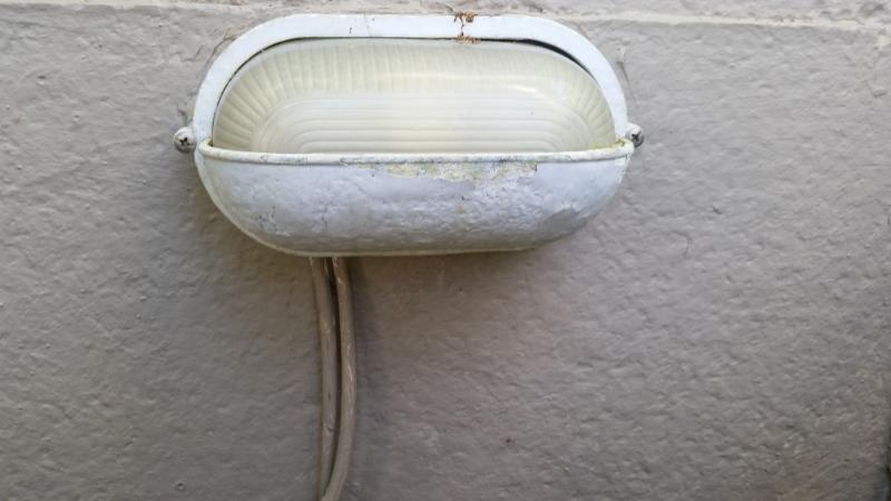

    The house we bought has 5 of these garden lights along the walls (inside our boundary):

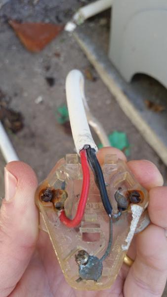

    They are powered off an outdoor plug socket which runs a cable to them that is simply buried in the ground along the walls (which are garden beds), not in conduit.

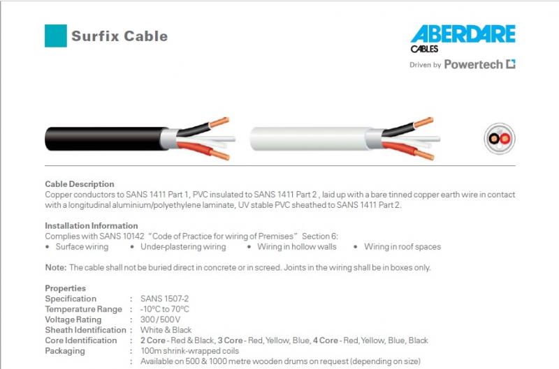

    and looks like this:

    Ironically the burying of that particular cable isn't against the regs but using it as trailing cable and fitting it into a plug is. That cable is known as surfix and it can be installed without additional containment such as conduit or trunking. I'm not sure about the white PVC, some white PVC cables aren't UV stabilised and can't be installed anywhere where they'd get direct sunlight, usually the black PVC cable is good for UV/sunlight but you'd have to confirm with Aberdaire because I can't see anything about UV stability on their website..
    You shouldn't mix electrical circuit cabling and irrigation valve control cables in the same containment, they should each be in their own conduits.
    **edit** if the neutral and earth wires come into contact in that plug you'll have an earth leakage tripping fault that will keep tripping even when the circuit breaker supplying that circuit is in the off position.

      if i did a CoC on that installation i would fail it on a few points. the surfix cables are " not suitably bushed". if there are no glands then the cable should be chased into the wall. surfix has to be buried a minimum depth . if its not in a pipe then there must be danger tape above it. as andy said the cable cant just be plugged in. i think white surfix cable is UV resistant. i phoned the manufacturer a few years back to confirm.

        Surfix can be buried directly in the ground and as it has 'metal stiffening' and in this case has earth leakage protection I dont believe any danger tape is required. I agree with bergie that these days the white and black surfix has UV protection.
            Andy can you please give more information on this quote? What regulation states that it is not allowed to be fitted into a plug?
            According to Aberdare Catalog both the white and black surfix are UV Protected.
            For interest sake, check the note on the picture.
            Reg. 6.3.6.1 The cables may be installed
            (h)under screed if protected by an earth leakage protection device with a
            rated earth leakage tripping current (rated residual current) IΔn not
            exceeding 30 mA.
            Reg. 6.3.6.2 These cables shall not be buried direct in concrete.
            I understand why concrete, but why according to supplier it shall not be buried in screed if it is allowed by the Regs?

                  Originally posted by MullerR
                  ...Andy can you please give more information on this quote? What regulation states that it is not allowed to be fitted into a plug?.....
                  Best I can do for a reg at short notice would be;
                  6.4.3.3 A cable shall not be bent more than is recommended by the cable manufacturer.
                  A cable trailing from a plug would need to be what's referred to in the regs as a 'flexible cord' and as such would need to qualify to this;
                  3.9.3
                  flexible cord
                  cable of which
                  a) the nominal cross-sectional area of each conductor does not exceed
                  4 mm˛, and
                  b) each conductor consists of strands of diameter less than 0,31 mm
                  My line of thinking in making the statement was that trailing cables such as cabtyre or HO5/HO7 etc are stranded conductors and designed to be sufficiently flexible to accomodate constant bending when hanging free/unsecured from a plug. Surfix on the other hand has solid conductors and would IMHO be totally unsuitable for termination into a plug. There's also an issue whether the terminations on the plug pins are rated as suitable for solid conductors and whether the cable clamp on the plug is suitable for cables with stiffening in the sheath.
