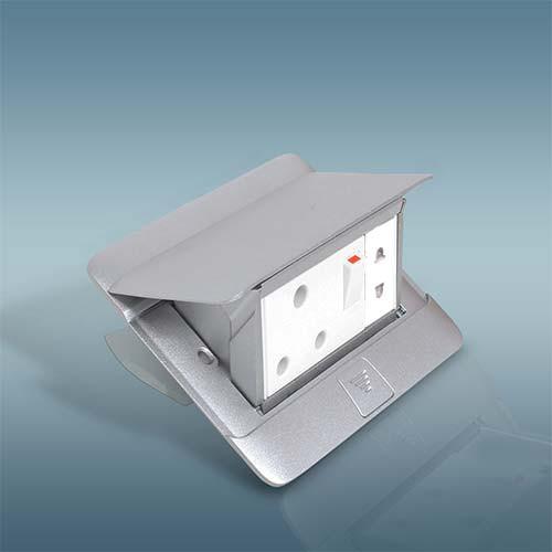

      Sorry, lots of questions...also pop-up, do you mean those floor sockets/ socket you sometimes see in kitchen counters that open and close flush after use? Yup. Only Legrand do a 4 module one as far as I can find but stock is a problem. Crabtree only do a 3 module, hence the need for to know about the switch thing. This thing would be teh ultimate solution but stock is problem and we need it NOW NOW.
