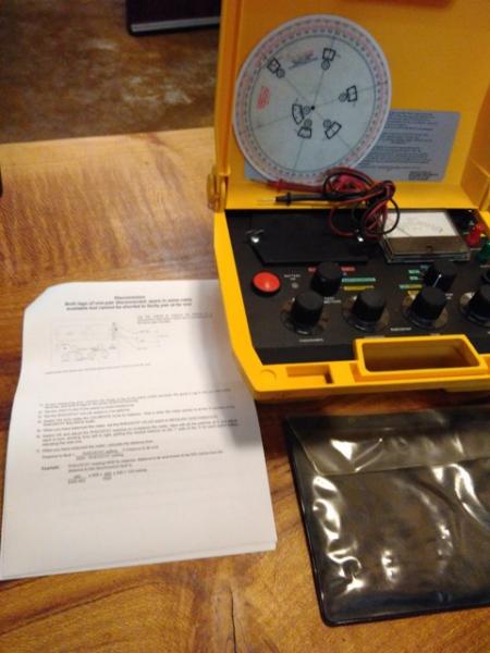

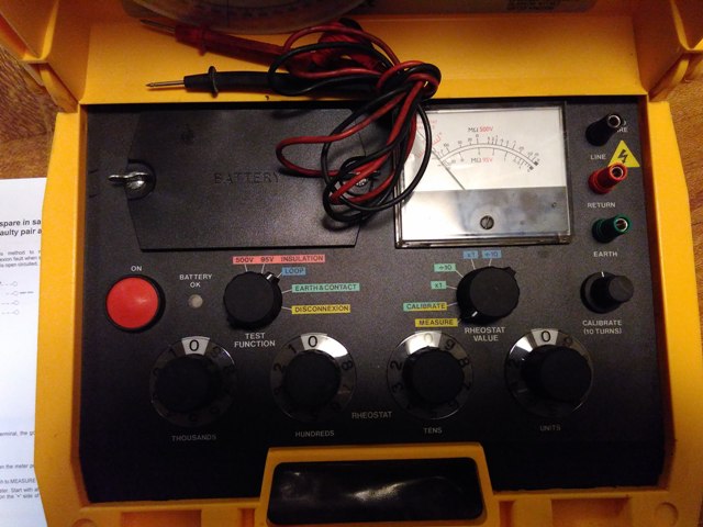

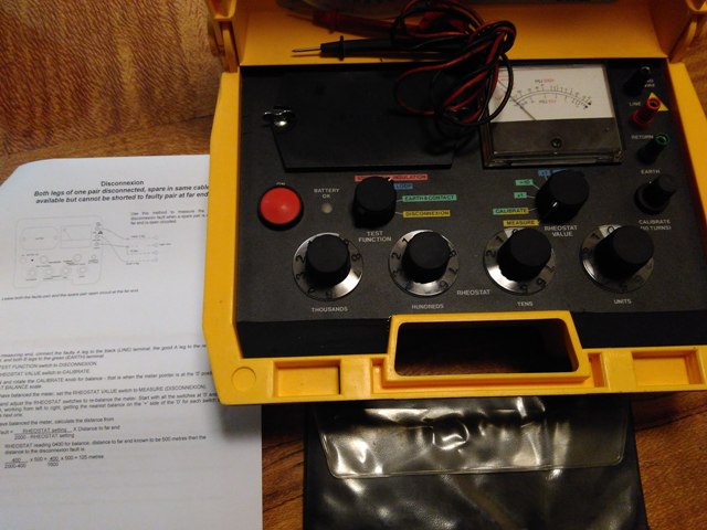

          The only cable fault locator I have is an old school balanced loop impedance type and I mean old school...it comes with a rotary slide ruler. It would score pretty low on accuracy compared to some of the newer technology units available nowadays but it scores very high when it comes to price range, I think I paid around R250 for it in the early 1990's.
          It has several good points such as it doesn't stress the cable insulation like some of the arc reflection devices that throw over a thousand joules of 25kv DC at the cable but as far as accuracy goes, it's best performance was within 1 meter for an earth fault on a 60 meter 16mm SWA cable but I can also remember an occasion where it was about 3 meters out for an open circuit wire on 20 meters of 2.5mm SWA. In all fairness I've not had it officially calibrated since 1996 because I can't find anywhere that will do it so that could be contributing to its inaccuracies.
          My employees hate it with a passion because it doesn't have wifi and integrate with mobile devices and even after several one-on-one demos and extra tutorials on how to use a slide ruler the only person who seemed to grasp it was my book keeper and she was just evesdropping on the sessions. I eventually admitted defeat and gave up educating them on how to use it as a bad job.
          I'm a bit confused with your link to the Nemtec fence energiser and that Syscompact unit is an absolute monster with 2100 joules at 32kv, I'd imagine the price would be high. I don't do enough cable fault work to warrant spending thousands or tens of thousands on a TDR tester, I use this one once a year if I'm lucky, maybe when I win the lottery I'll treat myself.
