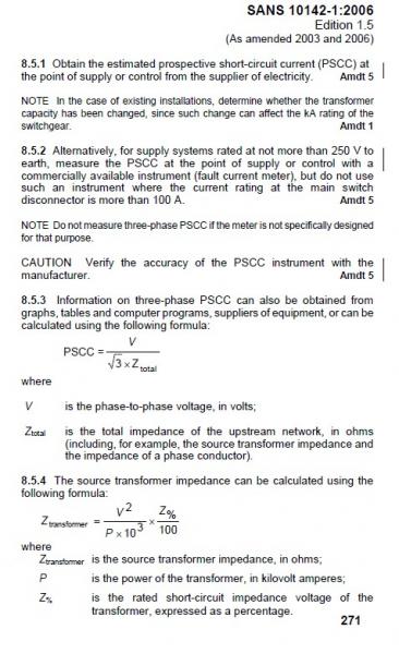

      How would you go about calculating it?
      • ACEsterhuizen
        • Mar 2012
        • 165
        Reg 8.5

          I hoped there's another way cause I never have access to get the transformer vaulues needed for the calculation
          • skatingsparks
            • Mar 2008
            • 376
            On most supplies its impossible to get to the transformer. I usually test after the first small breaker if I don't feel it safe to test directly at mains position.
            My meter, fluke 1653B, can test from 0 - 25kA. Its designed to handle such tests.
            Its pretty standard practice in most countries to test with a meter (well i can speak for the UK, Australia and New Zealand)
            If you are working with stuff with fault currents over 25kA then that is next level stuff. You must be practically working in the substation to get that kind of fault current.
            Fluke 1653B
            Computation: PFC or PSC determined by dividing measured mains voltage by measured loop (L-PE) resistance or line (L-N) resistance
            Range: 0 - 25 kA
            Resolution (Ik < 1000 A): 1 A
            Resolution (Ik >= 1000 A): 0.1 kA
            Accuracy: Determined by accuracy of loop resistance and mains voltage measurements.
              • 4927
              All live tests can be dangerous and should only be done in conjunction with a risk assessment. That said, impedance testers are designed to accommodate overheating, it's expected and there's built in protection to prevent damage from occurring so I doubt the 100A live-test limit in the regs is motivated by the protecting the instrument.
              I still use my old Robin loop tester for determining PSC, it uses a 25A test current rather than the somewhat limp wristed 12A test the new fandangled Flukes use . If there's three phases to test it often gives the overheating warning on the third test if I do them in quick succession. No big drama, no explosions just the warning light comes on and it won't perform further tests until it's cooled down.
              If you can't calculate the PSC because of not having the transformer details you should be able to take the Ics rating of the suppliers MCB as an indication of the maximum possible PFC.
              • W-TDMI
                • May 2013
                • 39
                Do your LOOP impedance test and use the formula to calculate PSC if your tester is not capable of conducting such test.
                PSCC=V/Zloop 1PH
                PSCC=V/SQ3.Zloop 3PH
                V In both formulas is measured incoming voltage:
                V- 1Ph (P - N)
                V- 3Ph (P - P)
                Regards
                TDMI
