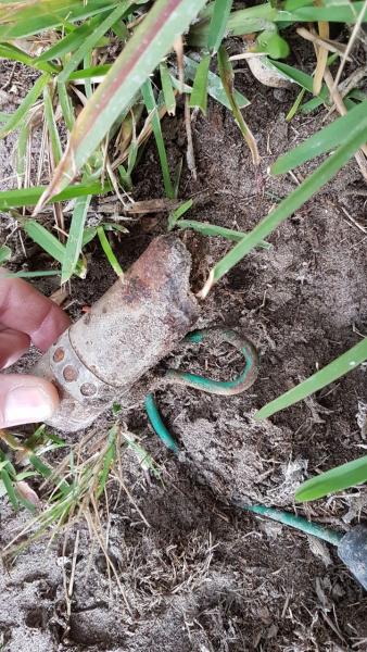

    I recently went to a client's house to quote on renovations .
    Pls see pic attached. Not sure if it has uploaded correctly.
    I found the earth wire connected to a galvanised pipe, (seen this many times before), but the galvanised pipe has corroded right off.
    This guy had already bought the house and gotten a certificate of compliance.
    I told the owner that surely they should have knocked in a spike or two at least and tested for good earth resistance.
    The owner contacted the electrician and the electrician said that an earth is not required. (P.S I am a qualified electrician with wiremans).
    Are there instances where this is the case? I know on the compliance certificate it says: "Earth resistance if required", so I'm wondering if I will learn something new today
    Perhaps if the supply is in a certain configuration it is ok?
    I know the transformer neutral makes the installation safe most of the time anyway but still feel there should always be adequate earthing nonetheless.
    Is that earth wire still connected? If it is it's in breach of the CoC;
    7 Connection of conductors and earthing and bonding are mechanically sound and electrically continuous
    Difficult to say if an earth electrode is required without more info.

      I spoke to the electrician who issued the C.O.C and he informed me that he recently had the refresher course for the latest 2017 Sans edition.
      I have been slack and not yet bought it but now realize I need to buy the new addition asap.
      There were a few questions I had regarding the certificate he issued:
      1. No earth electrode resistance test done and of course the fact that there was no earth spike at all.
      It is a TN-C-S supply as usual in these parts.
      His reply was that the regulations state that for existing installations the "secondary earthing mat/spike" on the clients property is not compulsory on a TN-C-S supply.
      The certificate is also passed under the "for an installation existing before this publication of sans10142"
      2.There were no insulation resistance tests done
      This he informed me was also not required for an existing installation.
      3. section 4 no. 15 "Is the position of a readily accessible earthing terminal..."
      This he had indicated "YES" but there was definitely none installed.
      He informed me that this was no longer necessary as per new regulations
      4. Lastly at the WC1 box there was 2 orange toggle circuit breakers (d curve), 50amp and 30amp. With a seoerate prepaid meter in the flatlet and main home.
      He had signed the flatlet off as a sub DB instead of having 2 separate certificates which he agreed is how it should have been done, but I would like to know if we are correct in that assumption in your opinion?
      I am not out to roast this guy or anyone else, I just need clarity if possible as i myself sign off homes and try not to bring unnecessary expense to the client although I prefer to be cautious.
      I know I am a bad guy for not yet getting the new addition of sans 10142 but will asap and plan to do a refresher course too as i feel i should know all this already
      Thanks for your time, it is greatly appreciated
        Similar to yourself I don't have edition 2 of the regs yet so some things may have been changed. I'm also not the best person to give opinions on domestic certification because I never do domestic work of any kind.
        Yeah, from the photo he obviously didn't do an Ra test on the earth electrode but, regardless if the regs state it's required, if it was installed and if it's still connected then it should be part of the CoC. The regs state the absolute minimum requirement but sometimes a higher standard may be required, especially when it comes to earthing arrangements. Is it plain TN C S or is it PME or PNB? Effectiveness of earthing is highly prone to seasonal changes and it may have also been the opinion of a previous electrician that a local earth rod was required for some reason, hence my stance that if it's there it should be fully functional and subject to testing and inspection during certification.
        Removing or ignoring deteriorating earth electrodes is extremely bad practice IMHO and I wouldn't be taking blase statements about 'not compulsory' or 'before publication of regs' as an excuse. If it was installed at one time then it has to be considered that there was a good reason and I think the onus to prove it's no longer required would then fall on anyone who removes it or fails to maintain it or claims it's unnecessary. The minimum motivation I'd be satisfied with is full earth impedance tests and earth fault disconnect times calculation to prove adequacy of existing earthing, also confirmation there's no special location or medical location requirements, also confirmation there's no alternative supply requirements (generator/UPS etc) and a risk assessment taking consideration of likely seasonal ground conductivity changes and local lightning requirements. Customer requirements could also play a part ie effective operation of surge arrestors for protection of IT equipment etc if they're installed.
