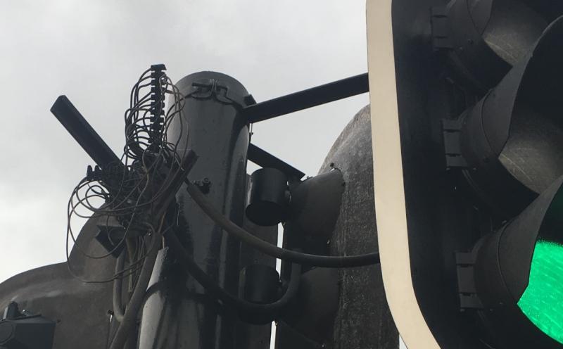

    So what are the rules regarding the use of "chocolate blocks" in permanent installations like this?
    Certainly explains why they aren't rain-tolerant!

      Looks like someone stole the enclosure. Choc block connectors are pretty much the norm.
