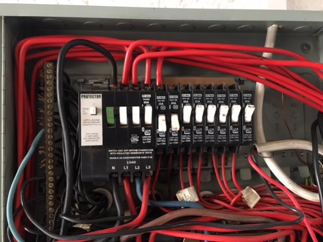

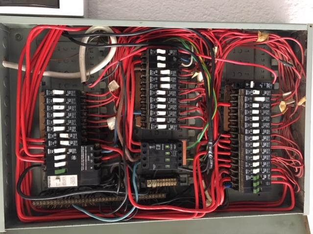

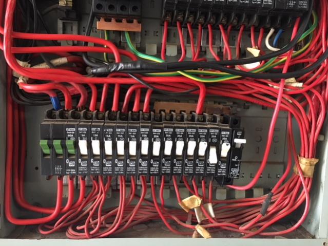

          BD Board pics
          Originally posted by GCE
          Hi
          reading between the lines and would not want to say anything until I saw a picture of the DB wiring .
          Could you possibly post a photo of the DB internal wiring
          Pics attached.

            Hi
            Dont see the need for a rewire
            The regulation posted above by Hotspot should sort out any argument - All the live wires are red which is not an issue .
            Without going into details there are a couple of things to be sorted out on the DB , but complete rewire of the installation is a no.

              Thanks all... Much appreciated.
                Looks better than a lot of DB installation i get to see on a daily basis.
                I think you need to get a second opinion.
