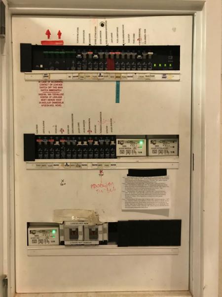

    Can you safely turn off the supply and give us a couple of pics of the inside and a pic of the full DB including all the circuit breakers? If you can't isolate the power rather don't, please don't remove the cover when it's live. I'll pop back when I have more tim,e later.

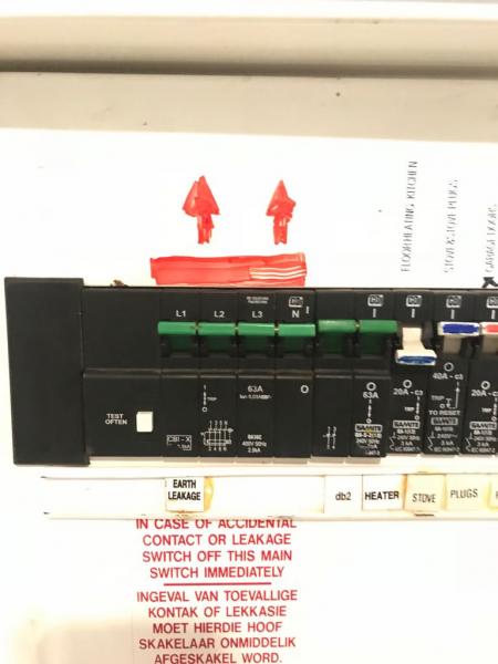

      Note on the front cover of the DB board:
Name:	WhatsApp Image 2018-02-27 at 12.55.53.jpg
      The whole DB board from the front. The circuits that are down are simply due to needing them on at the moment. They are working fine.
Name:	WhatsApp Image 2018-02-27 at 12.55.53 (1).jpg

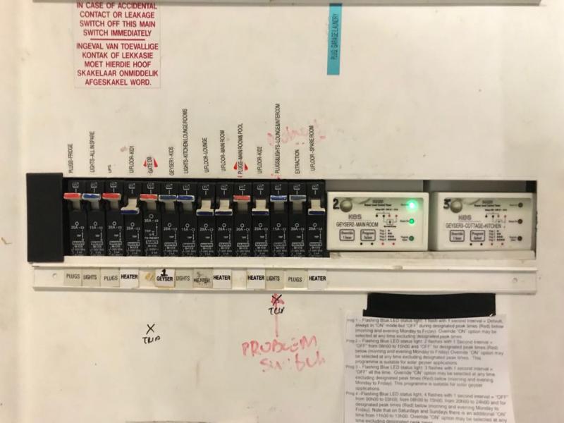

      Top Row of isolators:
      Had the thinggie (three green lights on) on the right installed by some chap on his recommendation -meant for lightning.
Name:	WhatsApp Image 2018-02-27 at 12.55.53 (4).jpg

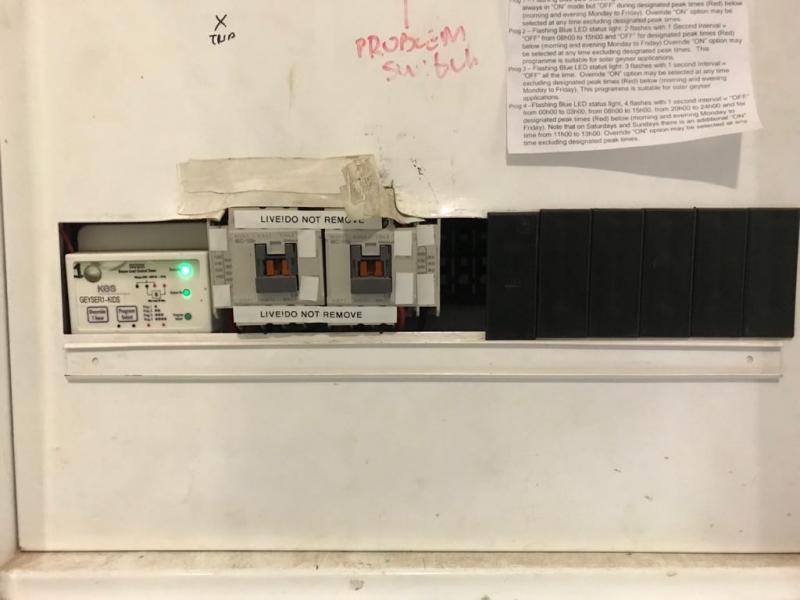

      Middle row... They geyser timers were installed sometime in 2013 by one of eskoms guys. When i checked last year one wasn't actually connected to a geyser! (when it showed off the geyser would still be on)
Name:	WhatsApp Image 2018-02-27 at 12.55.53 (5).jpg

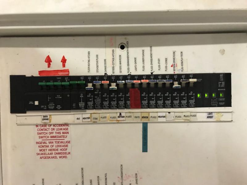

      Bottom row..
Name:	WhatsApp Image 2018-02-27 at 12.55.53 (3).jpg

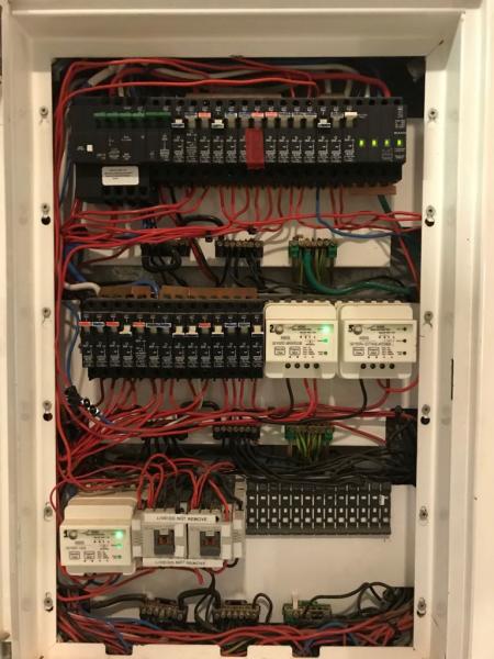

        and here is inside the DB board
Name:	WhatsApp Image 2018-02-27 at 12.55.53 (2).jpg

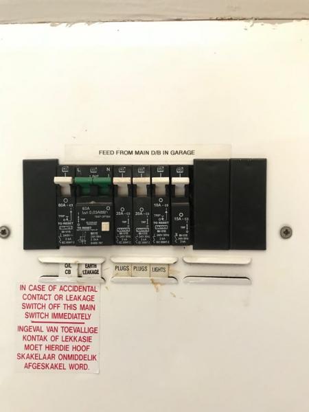

          This is the DB board that is "Fed"from the large DB board. On the large board it has the RDC labelled as "DB2" next to the the switch RDC.
          When the large (3 switch) RDC trips this smaller DB board still has power.
Name:	WhatsApp Image 2018-02-27 at 13.17.00 (2).jpg

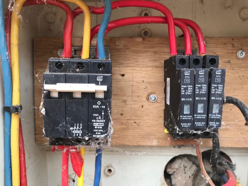

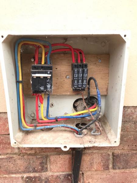

          I think this is the answer to your overload question. This is outside the garage. When i switch this off the large DB board and the smaller one have no power.
Name:	WhatsApp Image 2018-02-27 at 13.17.00 (1).jpg
Name:	WhatsApp Image 2018-02-27 at 13.17.00.jpg
            Yeah, there's several obvious compliance issues such as geysers which are fixed appliances on single pole breakers, what looks like 2.5 wiring supplied by 25A circuit breaker but difficult to tell from pic, lack of isolation for UPS supply, surge protection which is just duplicating the protection you have in the external box, overload protection in subDB is way oversized for supply wiring size....I could go on but most of this is off topic as it has no bearing on your RCD nuisance tripping issue.
            One question, if the triple pole RCD (labelled 'earth leakage' top left) trips do the green lights on the surge protectors (top right) go out or do they remain lit?

              Hi
              Reading the posts above , I could not restrain myself from answering and hopefully I have not missed RCD's in the attached pic's
              If I was called to have a look at the installation I would not bother taking out any test equipment and would expect you to be tripping on your main RCD intermittently, bordering on absolutely annoying.
              RCD's will trip when they reach 30mA of leakage to earth - Every appliance has a leakage to earth , some more than others and the worst offenders are heater elements , computers , transformers (UPS) , ants creating a nest in outside fittings , Lightning protection arrestors etc
              The sub DB appears to be fed from the main DB 3 phase RCD - If there is a fault under the sub DB RCD it could sometimes trip the 3 phase RCD in the main DB first as there does not appear to be discrimination
              If for argument sake we said that every appliance has 1mA leakage then 30 appliances connected under the RCD will trip the RCD without any actual fault.29 Appliances would allow the RCD to behave but a little moisture in the air and the extra 1mA to earth will suddenly appear and trip your unit.
              The 1mA is just for easy calculation and explanation.Each appliance varies and in any installation can change depending on what is being used at any stage and the age of the appliance.
              I would strip out the 3 phase RCD , I only see single phase equipment , and install multiply single phase RCD's - In my own house I have 5 units installed and I do not have a 800sqm house with 5 occupants
              This way you should reduce the potential leakage to earth on each unit and you can avoid putting unnecessary items onto the RCD's eg light circuits, depending on the application and installation.
              It will also make life easier to determine where the fault is actually coming from as the circuits under each RCD will be reduced instead of checking the complete installation every time there is a trip.
              We have found that in 80% of installations with 1 RCD and intermittent tripping , once we install an extra 2 or 3 RCD's we solve the intermittent tripping problem.
                @AndyD - when the triple RCD trips the three green lights on the surge protectors stay illuminated.

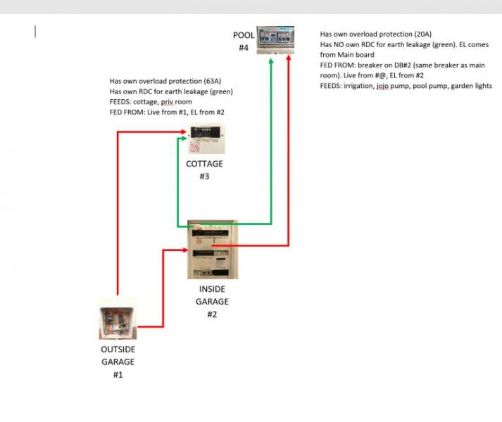

                    Where is the large DB located? (Is it in the garage, or somewhere else?)
                    Originally posted by GCE
                    The sub DB appears to be fed from the main DB 3 phase RCD ...
                    Possibly not.
                    What I'm trying to figure out is whether the "large" DB is the "main" DB, and where is the main switch disconnector for the entire installation.

                      Large DB = Main DB and is inside the garage. It is fed from the #1 in the figure below.
                        This truely is a bizarre installation and the only thing that's for sure is that you're going to need a decent electrician and whoever it is he's going to earn his hourly rate on this one.
                        You've got several issues with this, firstly is the obviously non-compliant nature of the installation. This is the one that would worry me the most and I've also no idea how this installation could ever have been issued a certificate in this condition.
                        Secondly, as GCE pointed out, the general layout of the earth leakage protection is an open invitation for tripping problems. This isn't a compliance issue as such, nor is it a safety issue. From an electrical point of view any tripping wouldn't actually be a fault because everything would be doing its job and working as intended, it's just a user inconvenience issue.
                        Where to go from here is the tricky one. Your primary concern was tripping during thunder storms but I'd suggest you'd be better treating the obvious issues first before specifically chasing this problem. If the Main DB is better laid out with several single phase earth leakage breakers instead of the 3-phase one you have now then you may find your tripping during storms problem just disappears on its own. Whilst the reconfiguration of the main DB is being done I'd also remedy any other compliance issues within the DB at the same time and obviously fix any poor IR readings on the final circuits. This would be the most cost effective and whilst it shouldn't cost a fortune there would be a substantial cost involved.
                        After the main DB is fixed I'd get him to look at the sub DB to ensure it's on its own earth leakage protection and not supplied via an earth leakage breaker in the main DB which would present discrimination probles if there's a fault.
                        I'd also suggest you get your sparky to check earth impedance of the installation as well as neutral-earth voltage under load. There's a possibility the tripping during storms is a result of an earthing issue outside of the installation on the supply network.
                        Finally, any decent sparky would by now be familiar enough to let you know if any of the circuits need repairs so this would be the final step toward a safe and compliant installation.
