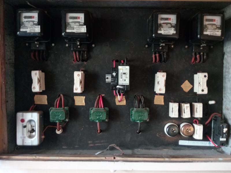

    I have been roped into a domestic on an OLD building (you know th eone where you have to help your best clients friend out....).
    A top floor flat is being split into 2 units and totally rewired - no problem
    There is an existing supply to one flat which is in the old cloth covered cable so I suggested we pull 2 new supplies from the floor DB.
    The supply to the floor DB looks like this....
    Now obviously its Oooooold. I did a Earth fault loop test at this point and checked there is a separate earth run up to the floor. All good (Earth fault current 0.68kA with 0.34 ohm E.F.L.I.)
    My question is - point of control.
    Am I responsible, in terms of the COC for the cable rising up to this floor. When I have worked on complexes there is meter box located some where near the flat and that I consider the point of control to be at that meter box. Am i right in saying point of control for the installation I intend to do is at the double pole isolator before the meter
    My plan is to come from the green connector block with a new cable, install a 2 suitably enclosed/rated double pole circuit breakers before going to the existing meter and another new meter (still discussing if the body corp will give me the meter or if I must install or if it must come from municipality). From there I will run 2 sub-mains to new DB board positions in the flat which has now been split into 2. Does it depend on who the meter belongs to - if yes it belongs to the body corp of the building - they bill the tenant based on that reading
    The riser cables look to be 25mm I can only see 2 phases and neutral but each phase looks to supply 2 flats.
    Now I have pointed out to the body corp the cables in the riser are old.
    In term of liability - is my point of control at the double pole circuit breakers I want to install. The body corp won't let me alter or change anything prior to this meter cupboard.
    I have checked that the earth at this point will cause effective operation of the protective devices i plan to use but I'm not keen to put my name to old school cloth cable (as I call it).
    Opinion....

    Is there a neutral-earth bond anywhere in that floor DB? From what I understand of your planned installation your point of control would be the new D/P MCB's.
      Thanks Andy. That's kind of what I thought. There is no N-E connection in the DB. I believe its a TN-S system as the earth fault loop and prospective short circuit readings were not so close.
      Just discussing with body corp who will put in the new meter and double pole isolators in.
      They are obviously not going to up grade there risers. They look in OK ish condition and if the E.F.L.I reading are ok then I am happy to connect a new sub-main to it, so new cables from supply to double pole isolator to meter and from meter to new flat DB position.
      The risers come from the LV room downstairs and they say they don't have access.
      I was just asking about the point of control because there is no way I would want to put my name to something which still has the old style cables. I advised them its time for a upgrade but no response.
      I went back and checking around the area all the flats in the area are the same story. Some of the flats have been rewired and new double pole isolators put in, existing old sub-mains as is.
        • 4927
        The floor DB looks like it's in servicable condition so I wouldn't have an issue if the test results are good. I'd maybe include a disclaimer that given the age of the VIR wiring, whilst utmost care would be taken i'd exclude myself from liability should anything disintegrate during the installation.
