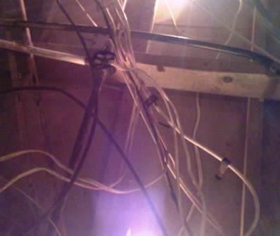

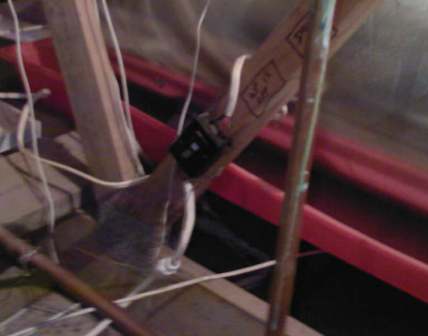

      this could be your ceiling...no cover on the junction box twin + earth connected straight in the top of the box...the people who do this work call themselves electricians...i can see why i am out priced on all the jobs i quote for because i sure as heck could not live with myself if this was the kind of work i was offering but again i will say...the customer wants the cheapest quote this is what you get...i just hope for your sake your house doesnt catch on fire because you and your kids could be in the house sleeping at the time...at least you wont have to worry because the insurance will more than likely just pay out...not do an investigation to determine whether or not it was caused by faulty wiring...you would need to be careful because they to will get wise one of these days at the rate buildings are burning down...as you know if you have an accident and your tyres on your vehicle are smooth or your vehicle is unroadworthy they will not pay out for the repairs to be done...i am sure they are going to get wise when it comes to pay outs for illegal wiring which causes your house to burn down.

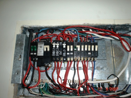

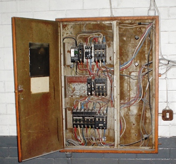

        to the man on the street you wont even see a problem here...the 30 amp circuit breaker has been bypassed and it is now tripping a 50 amp circuit breaker upstream...by the way this DB is in the frail care centre of the old age home.

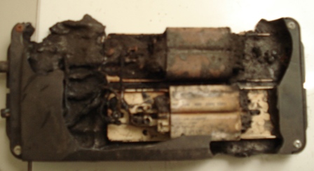

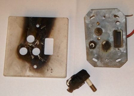

          this person smelt something burning...i found this behind the washing machine...the fire had already started.

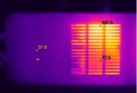

            i took this image while doing a routine check at a customers premises note the temperature 102 degrees

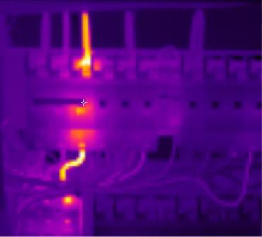

              you wouldnt even see this with the naked eye i was called out because there was a buzzing sound in the DB...i identified the circuit imediately with my thermal imager then procceded to test the circuit with a current clamp the idiot/electrician who wired this panel didnt even do any load tests the blue phase was loaded at 74 amps on a 60 amp 3 phase circuit breaker...the red phase had 10 amps and the yellow/white 16 amps... i balanced the phases and now it is working fine.

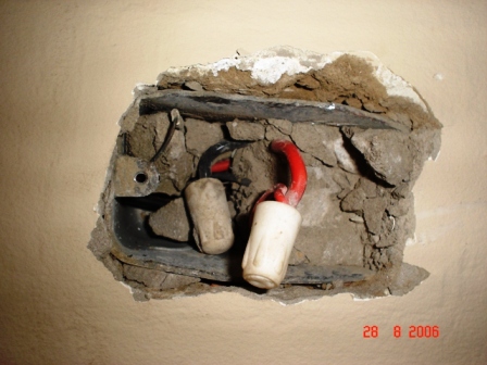

                      2 things wrong here firstly the box was plastered closed and secondly the one wire is a 4 mm and the other 2.5 mm if there was a 20 amp circuit breaker in the DB feeding this circuit it wouldnt be a problem... but the fact that there was a 30 amp breaker makes it a problem...it is extremely difficult to find a box plastered closed...so if you see an electrician doing this take a photo report him and record it for your own good.

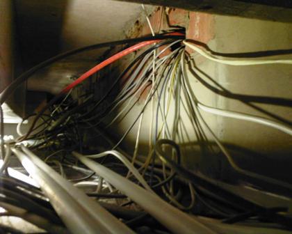

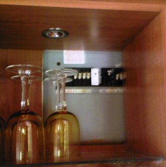

                        can someone please explain to me how on earth you get the cover off this DB to carry out routine maintenance or add a cable or replace a circuit breaker because i sure as heck couldnt figue this one out...i had to use extreme force with a big wood saw... the owner wasnt impressed... but hey... he should have thought about that when he told the cupboard company to cover the DB in the first place.

                          if this is your DB best you be getting an electrican who knows a little about electricity.

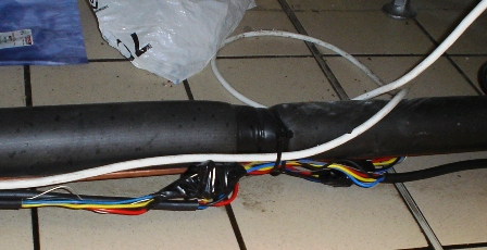

                            this picture looks harmless...where in fact this is one of the most dangerous pictures i have...this is a 3 phase 400 volt cable strap to a refrigeration pipe below a counter in a shop...the cable is joined together with connector blocks and taped up with insulation tape... so what is so bad about that you ask...well the firstly it is on the ground the joint are not ip65 which means that when the people working here get the mop and start cleaning...the joints are submersed in water... how someone hasnt been electricuted here yet i am still puzzled...the only explaination i have is that when they clean... the motors are not running or they are standing in gum boots cleaning.
