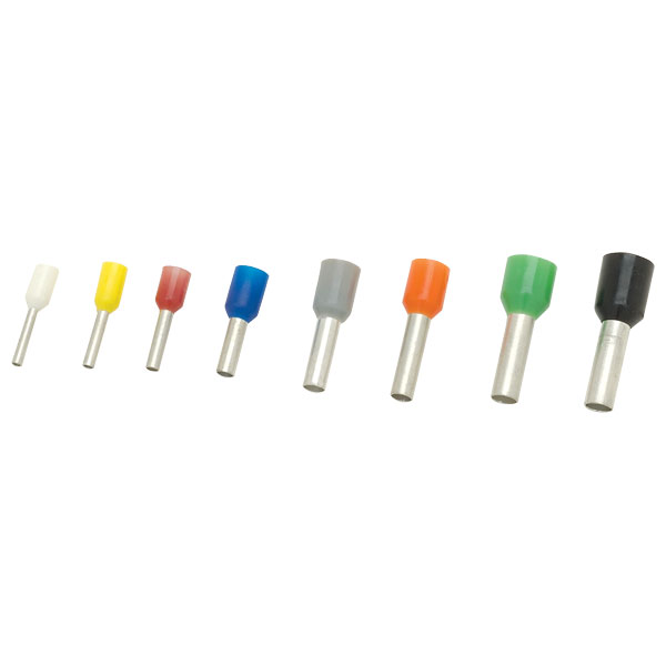

    Hi all
    Curious, what is the compliance level on ferrules?

    The ferrules you've shown are bootlace ferrules, they're used for fine stranded wire when you have a screw type termination that's not designed for fine stranded.
      Interesting, in your experience is there a ferrule or connector that you prefer to use when wiring plugs or do you prefer just using the raw copper cable?
